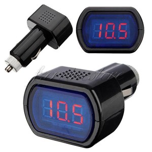

Get a voltage gauge/meter in the car. One that you can keep an eye on any time you're driving, great for intermittent faults when a multimeter on the battery might not show anything up.
They're stupidly cheap direct from the far east, so don't expect them to be accurate to the 0.1volts that the display reads, but they will tell you if it's charging or not. Also considering the price don't expect them to be the most long lived or reliable of things, so order several.
Many different suppliers, so I'll let you find the cheapest.

^^^^ They're amazing, I have one in every car and on the boat. Worth every penny.

After the installation of one of these beauties,
I finally decided to bin the old charger in favor of a modern electronic one. :idea:
