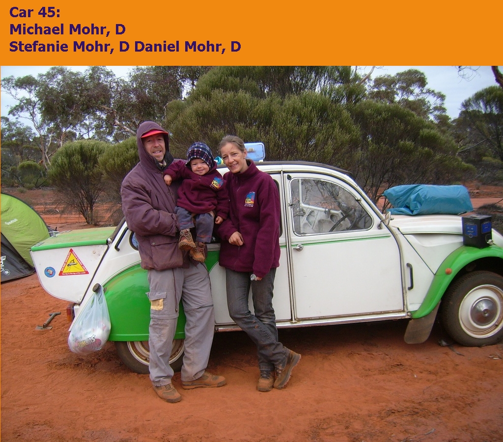

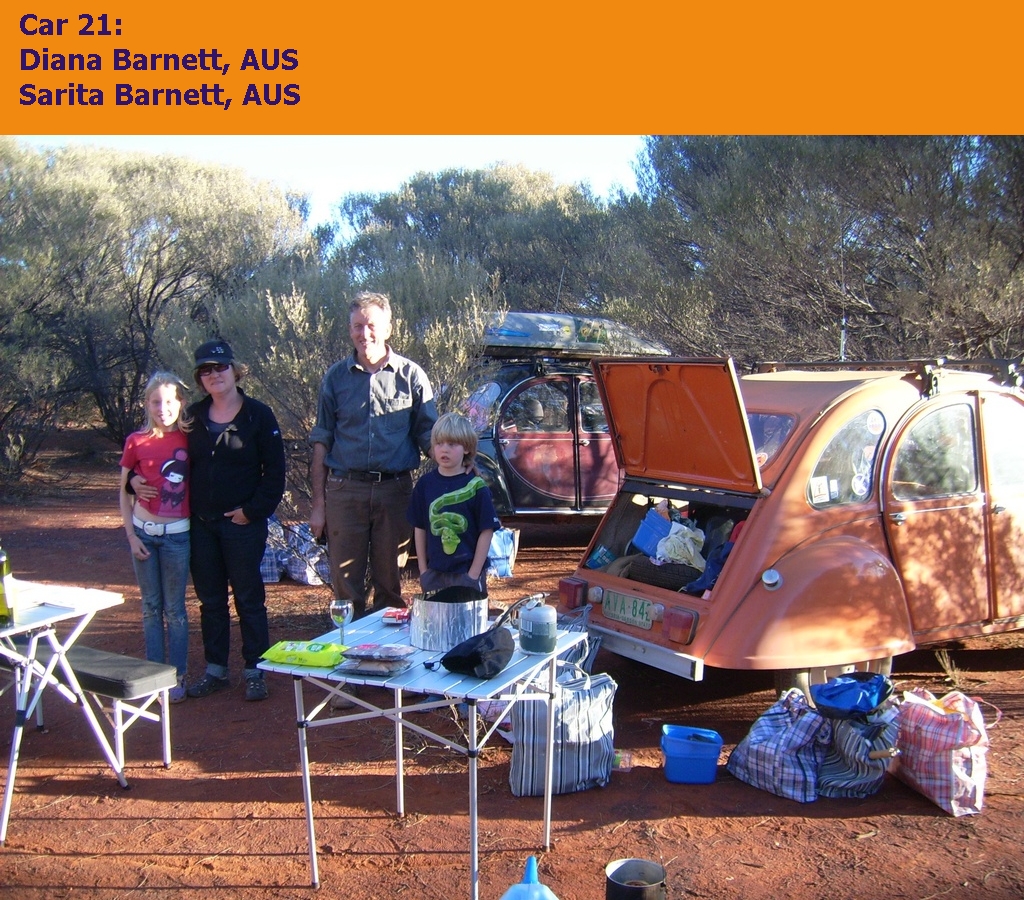

Now that’s what I call a proper equipped kitchen Image
Put one of them coffin on and you'll be all over the road. In case of an accident, you got the box handy Image
