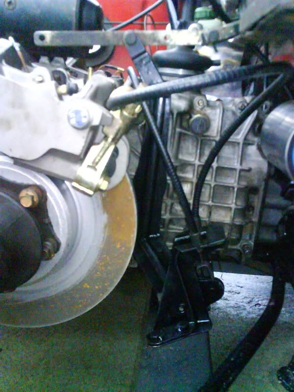

I found this pic that helps me understand. I wonder if the GS handbrake mech is the same... probably not... I shouldn't have to much trouble getting one here in Oz, if Gricey hasn't got one Viking will sort me out! ;)

Another similar pic here. The 'box might sit further forward when behind a standard engine, but I needed to modify the lever to clear the calliper. Looks like it's a bit close in the other pic too. It was much easier to mount after I made captive bolts, a big oval washer with two bolts welded through it, just about visible.
