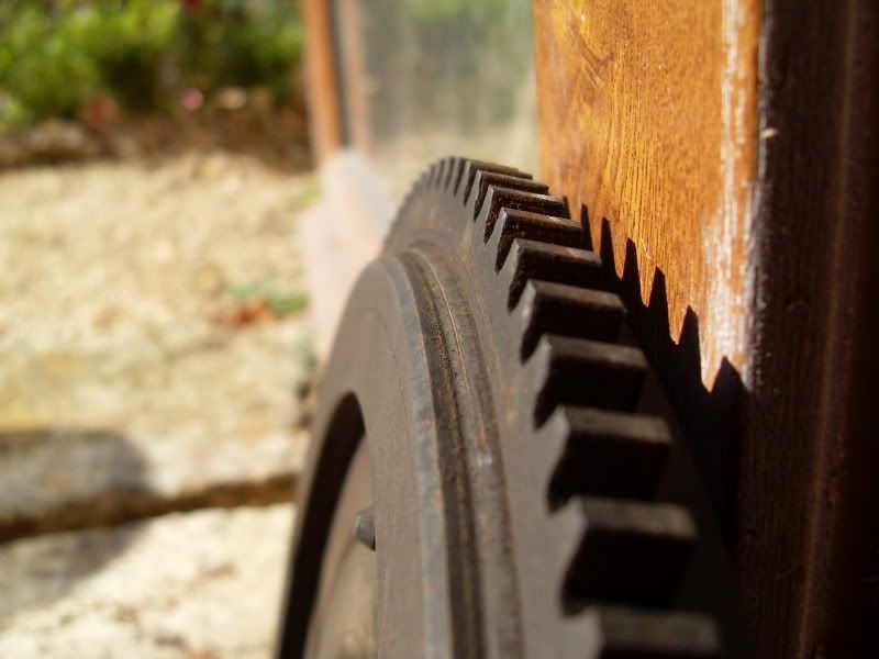

My Bee-emm engine uses a late type 2cv flywheel (from an E-reg) with the ring gear moved back so that its flush with the rear face.
However I was looking at another flywheel today(diaphragm type again, unknown age) and spotted that there was a step just behind the ring gear which would stop it from being moved back, as the flywheel diameter would be to small. Hopefully you understand what I mean, the picture should help. I then had a look at another wheel, on an engine from an E-reg again, and it was the same.
I know this probably isn't something anybody's had reason to notice before, but is there any chance that someone with a shed full of engines/flywheels could have a quick look over them and just confirm that I'm not going mad and that there are differences.
And just while I'm asking, heavy flywheels/light flywheels, did they change with the clutch type? ie. All coil spring clutch flywheels are heavy and all diaphragm clutch flywheels are light?

Well,
since technically it is 'tomorrow morning', the split is about 50/50 in that lot between those with the step and those without.
Nil desperandum? ;)

Post Re: Flywheels, different types?
Any idea if the step/no step thing is age related, which came first, and when the change might have been? I think I've had both types from E-reg cars. Maybe I'll peer under people's bonnets at the weekend.
October 14th, 2010, 1:27 am
Joolz,
genuine 26,000 mile 'G' reg 2CV checked with original engine, number 0909... and there's no step on that flywheel.
No idea with that other lot, which have been sitting there for about 10 years undisturbed...
It's probably as simple as different suppliers, and whichever supplied the particular batch in use in the factory at that time.
Might be a Portuguese/French thing, I s'pose.
