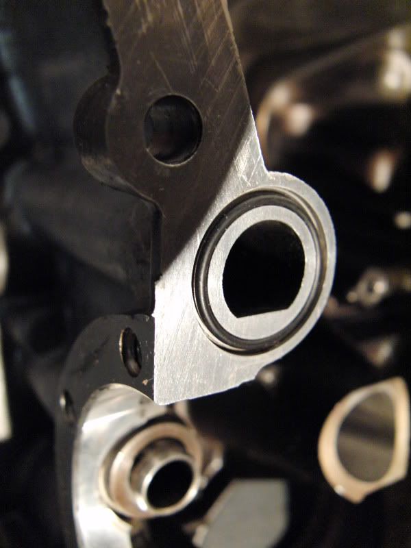

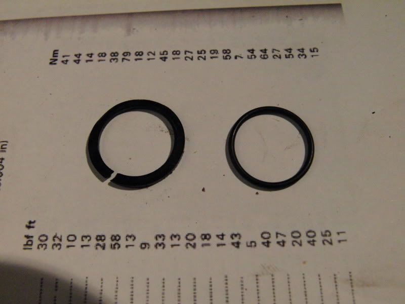

Looking at the seal kit i have i don't seem to have the correct relief valve seal :? The closest match i have seems to be to thin or is it correct?
Original left, new Right...

I've never yet had to split the cases on a Visa engine, so not much help with hands-on stuff.
Looking at the Haynes manual, the O ring which is fitted in that groove does look to be a 'loose' fit, however it's not as 'lost in space' as the one you've shown.
There's also a photograph of a circular seal which is square in cross section fitted onto a spigot, but I cannot make out where that's located...
Maybe between the oil pump and the crankcase?

Ken, i think the item you are reffering is the crankcase seal, 64.1D in my Hanes manual (which i found, my mate was using it as a paperweight) althought there is a larger square cut seal i have not researched yet.
Another note is that on later engines "Bypass valve duct O-ring" is not fitted...?
