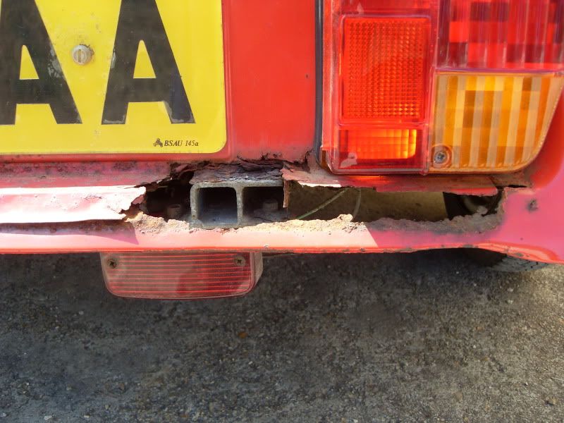

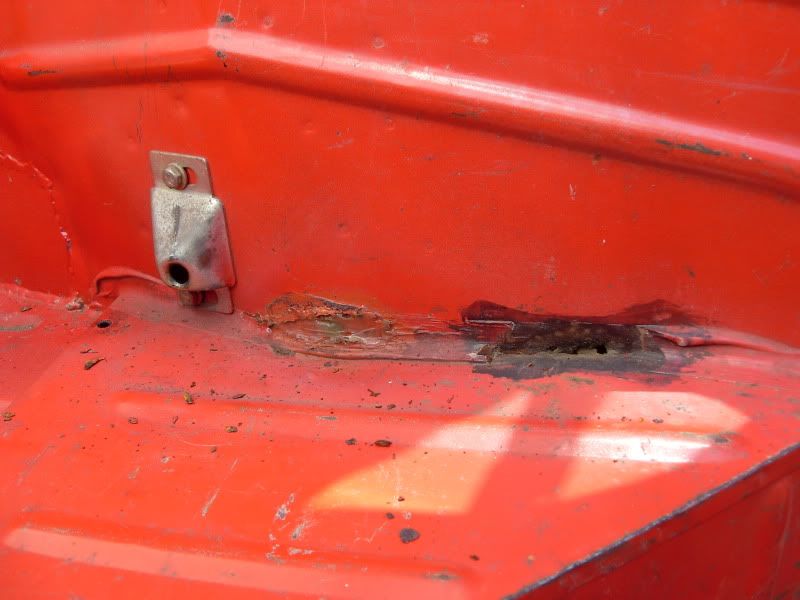

Number 1, the back panel/boot floor, are body to chassis bolts one of those important points that mustn't have substantial corrosion within 30cm? And would this fail on sharp edges as well as structural integrity?

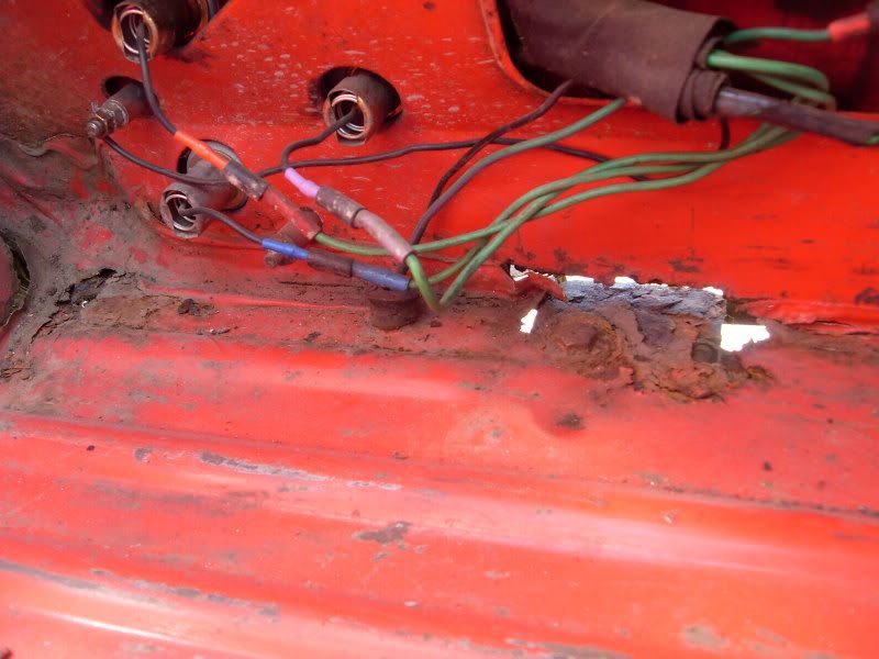

2 Bump stops, do they count as a suspension mounting point? And if so would these two holes count as corrosion within 30cm?

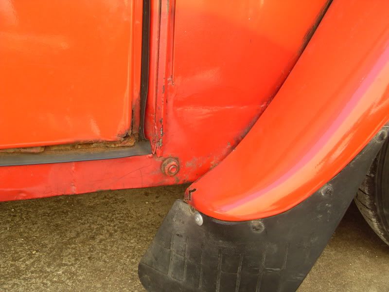

3, Spot what's wrong here, the bracket has parted company from the wing, it only wobbles a little, could it be a failure point? would anyone notice if they weren't looking for it?
Yes.
Down to the tester. I wouldn't have thought so.
Yes.
You should be OK, I'd think.

Re the rot on the back panel. My yellow 2cv passed an mot without even having the rearmost chassis bolts in the bootfloor, and the bamboo passed it's mot with a foot long hole across the back panel. The old man, who's an mot tester said he wouldn't fail my red spesh on the hole in the back of the inner wing (within 30cm of the back of the chassis) or the rot in the rear sweeps which is within the same prescribed area. However, he said he would fail it within 30cm o the bumpstop and/or seatbelt mounting.
If it were my car, I'd simply tape it up for now with several layers of gaffer then spend my time on the other areas. I'm guessing it's 24hr weekend when you'll be over, so if you need a hand with anything let me know, I'll see what I can do.

'course, they're still within 30cm of body-chassis mounts and suspension.
But if there's no bumpstop fitted, the bumpstop ceases to be suspension... <thinks> Who do we know who don't fit bumpstops to rebuilds?

The bit at the back can be failed, all body to chassis securing points are testable. Note that sharp edges are also assessed from the point of a stationary vehicle having a pedestrian walk past it.

As for your car Joolz, it it were me testing it and you had no back seat in it, I'd ask you to put some gaffer tape over the holes in the rear lamp panel, cut your rear bump stops off and self tap/cable tie the front wing to the car.
The wording regarding corrosion in a body mounting area is something along the lines of " insecurity of the body or its supporting members to the chassis so that it is clear that there would be a danger to other road users"
I got a mark down on my MOT training regarding body to chassis corrosion because as far as VOSA are concerned, there are sufficient body mounting points on most vehicles with chassis to allow a certain amount of flexibility. However, I doubt that would always be the case come MOT time.

1, Corrosion around rear body/chassis mounting, the testers manual says,
Reason for Rejection
3. Any deliberate modification, excessive corrosion, damage, cracks or inadequate repair of a load bearing body or chassis member which seriously affects its strength within 30cm of the body mountings.
But then it also says
Individual defects are not subject to Reason for Rejection 2 or 3 unless their cumulative effect is likely to reduce significantly the overall body security.
So does that mean that providing it's the only mounting in this condition then it shouldn't cause a fail?
The car's usually has the back seat fitted, but the two holes on the inner wing are very small, I can't find the bit in the testers manual, but doesn't it contain something along the lines of 'corrosion which seriously affects its strength'?
