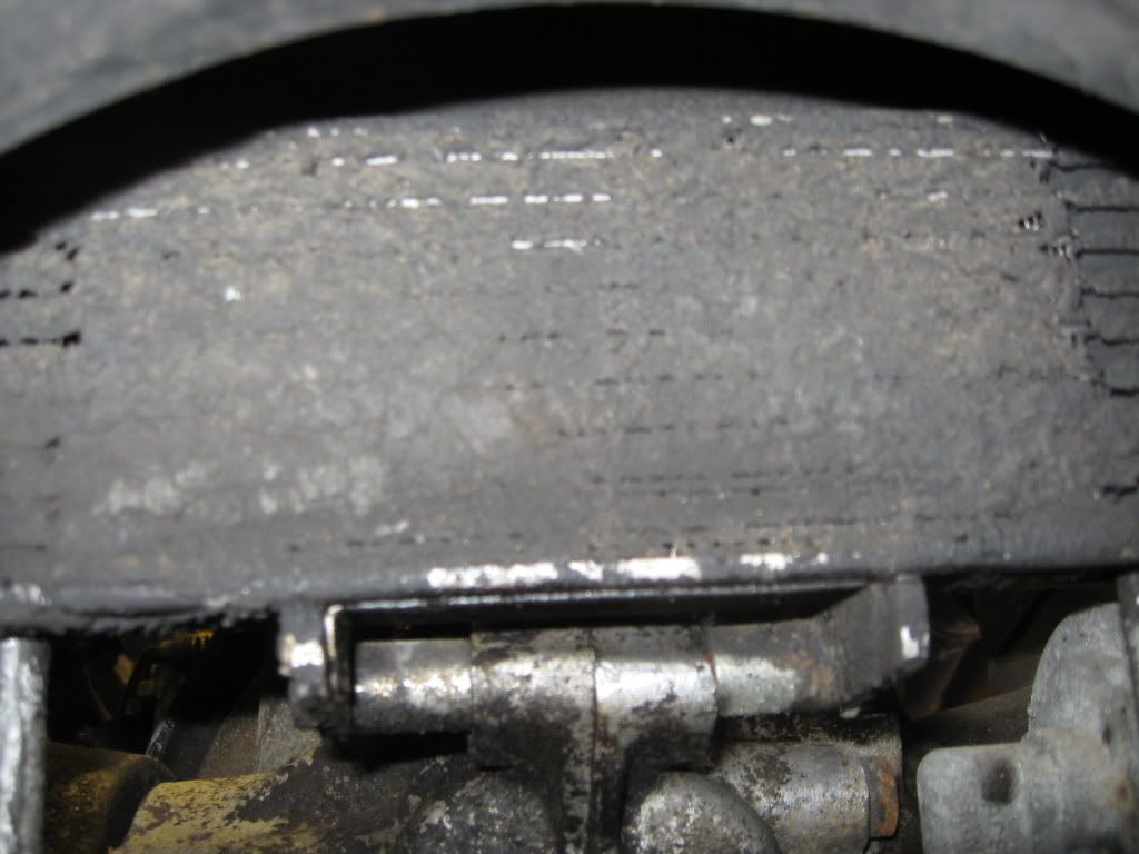

This was the state of my oil cooler once I'd got the fan off. From memory I sprayed it with engine degreaser, allowed it to soak in for a few hours then using air from my compressor blew the muck out from the back forwards. How the engine didn't overheat before, I'll never know. :o It's now immaculate so the engine now has a sporting chance.
