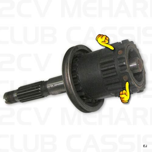

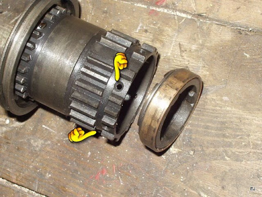

Third and the reason for this thread; The syncromesh for the 3rd gear have come loose from the rest of the gear-shange-thingy :o
See the pics. First's show how it should look, second shows the missing umm.. whats-it-called, that holds the syncro to the rest of the piece:
What can be done to this?? Anyone heard of it before?! Is there a way to lock it in place? It seems I must buy the whole thing if it must be replaced, and it costs.....well, too much.

if you think that part's expensive, how about a
< http://www.mehari-2cv-spare.co.uk/wheel ... 13744.html >
at a cool 1,000 Euros before Club discount? :lol:
I'd guess it's game over for that 2nd/3rd sliding pinion, but the rest of the box is probably worth keeping for spares.
Quite a few of the bearings in the gearboxes are stock items, btw.
6304NR, 6205NR, 2 x 62052RSC3, 2 X 30207 spring to mind... ;)

Common problem, rivots falling off. Bin it and get a good used 2nd/3rd sliding pinion or new. We have stock both new original and good used. Repair is possible but too expensive compared to new parts.

Thx guys. You confirmed what I thought. I'll just keep it for spares then.
