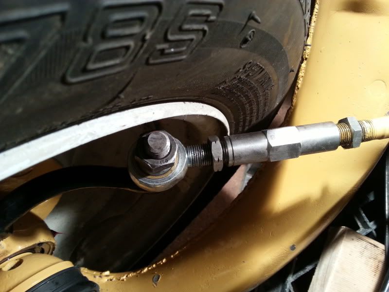

My nipples work! In one side, out the other :mrgreen:
The suspension arms where not as sucsessful, I can get the grease in but it is to much resistance to push it out without filling the cavity like we discussed earlier. I'm out of time to do anything about it, so another job for next time ;)
I also fitted my modified steering arms, they fit!
6mm clearance between the nut and the rim.

Looks good and on Snail too..
