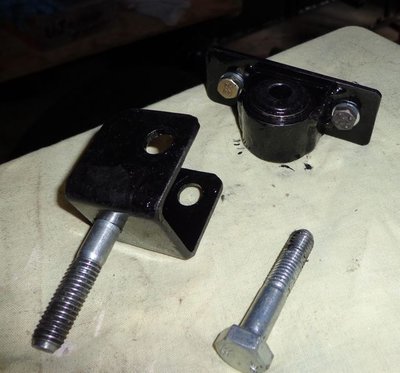

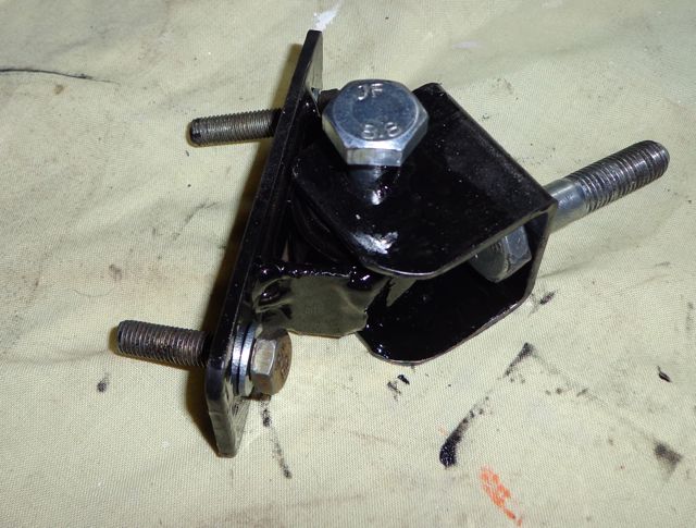

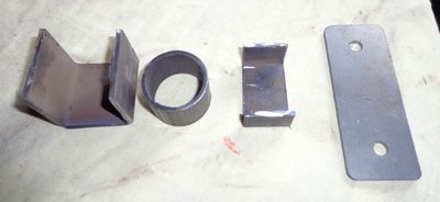

Engine mount modification from the 4x4 bois.
subarupete wrote:
Bit of a Diversion from the 4x4.
Broke three engine mounts in France, they are not designed to take a lot of abuse.
Fabricated a Heavy Duty Version.
Bits, Bush is from Citroen/Peugeot (Thanks to LB)
Will fit in the same way as a standard Mount, but if the bush fails the engine wont move to far.
ken wrote:
Pete,
some other solutions, both of which I've used successfully on 2CV racers.
Drill though the middle of a standard engine mount so that an M6 bolt and nyloc nut can be fitted, tightened so that the rubber is just starting to be compressed.
Once installed with the engine's weight on it, it has no effect on the mount's isolation characteristics, but will prevent it being overloaded in tension.
The other method is to bind the middle section of the mount with strong nylon twine, with the knot on the top side so that it's clamped securely when the mount is bolted to the engine.
This will act in the same manner as the bolt and nut setup, however the MOT tester may be asking some questions. ;)
Ken
