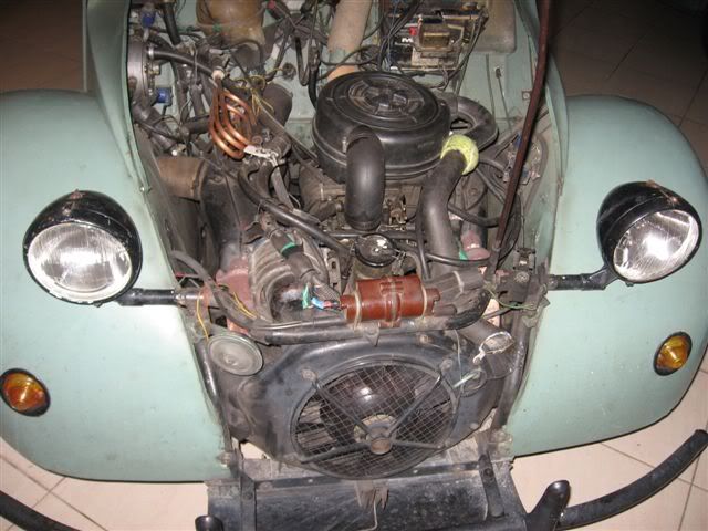

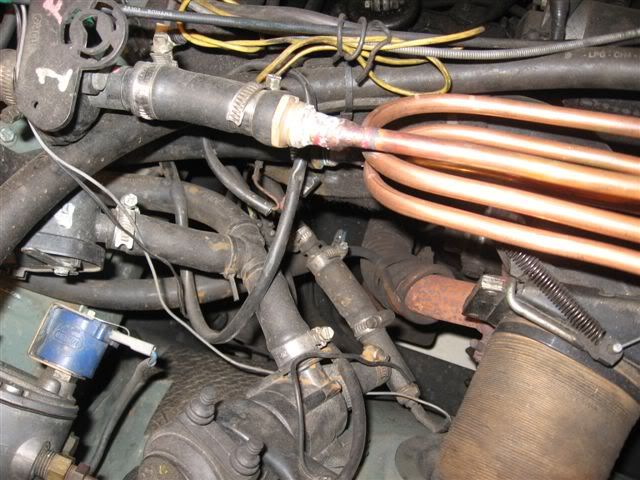

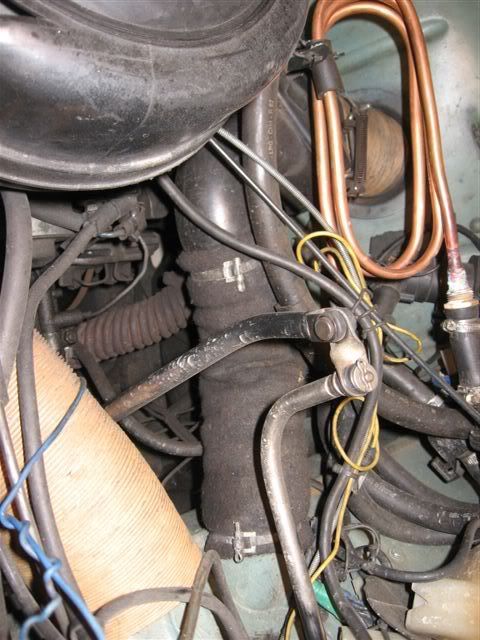

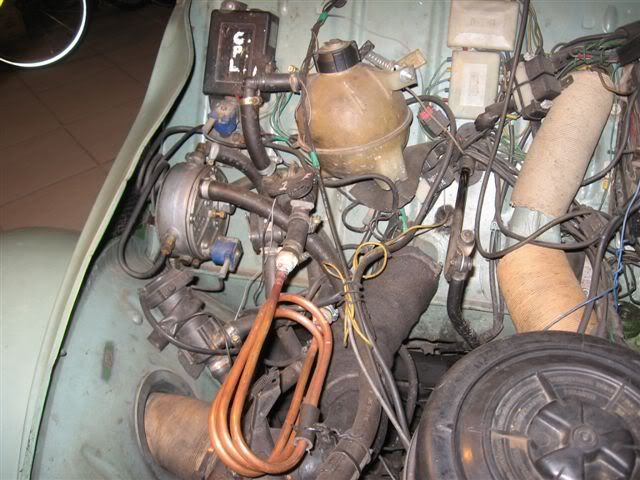

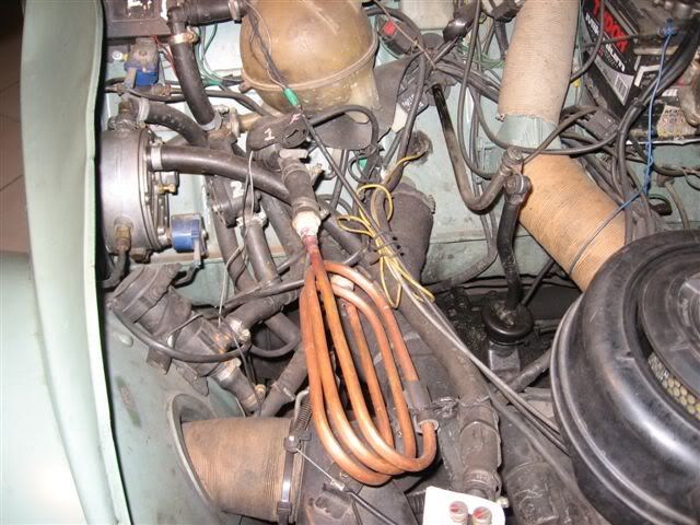

Here are Vitors pics of his water circuit.
Pic 1
Pic 2
Pic 3
Pic 4
Pic 5
If you could explain a bit pls;)
