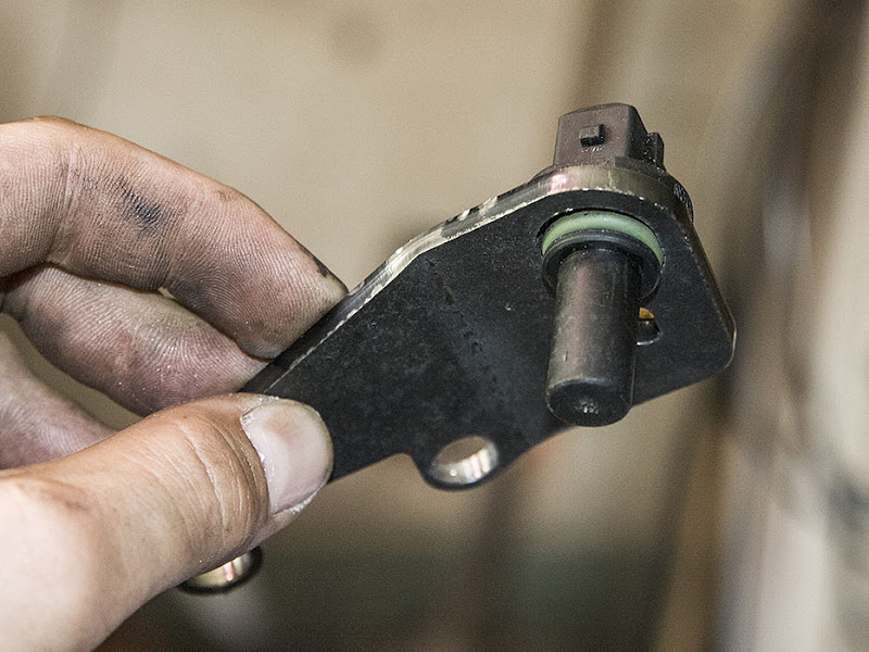

As of today, my 2CV is running on 1-2 Spark. It's absolutely awesome. Here's some ideas for sensor mounts etc.:
I'm using a Fiat double coil, with a 3,3 ohm 100W resistor (it has only 0,5 ohm resistance by itself and would try to draw a HUGE current)
