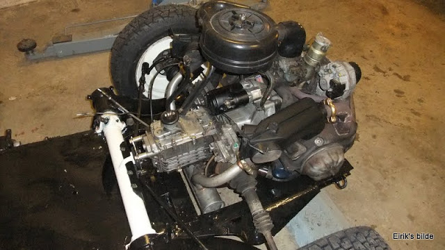

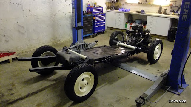

The chassis is now back on it's wheels, a complete rolling chassis again, with engine, gearbox and fueltank!! That was a nice moment.
The engine got a new original Valeo clutch, and are getting a DG-Nition ignition, and I'm going to try and waterproof it. The DG doesnt have all the small holes in the electronic plate, as the 123 have, so I'm just sealing along the edges of the el.plate, the led-light and where the cables go. Other than that, the engine should be good. Starts easy and runs very well. Fan housing will get some paint later, when mounting the ignition.
The gearbox also runs well with no noise. But it's good practice to check the gearboxes for the normal issues, so I opened it and peened the selector ring, which was still in place and not loose. However, both the nuts behind the back cover was loose, so I torqued them up and peened them.

All four suspension arms are from the AMI6, but the cross members are 2CV. In the front because of the steering issue, and at the back because the car will get LHM and 2CV-brake piping.
