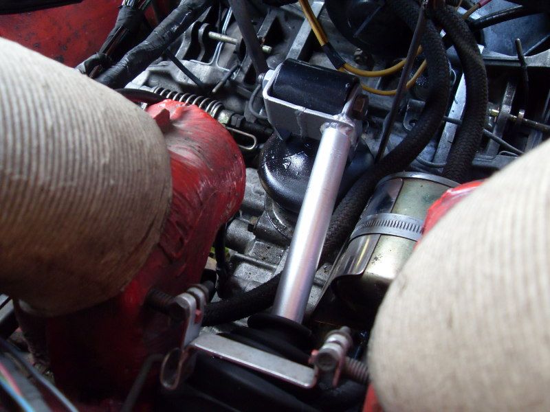

The photos I posted were taken off the net - some guy building a Dakar 2cv.

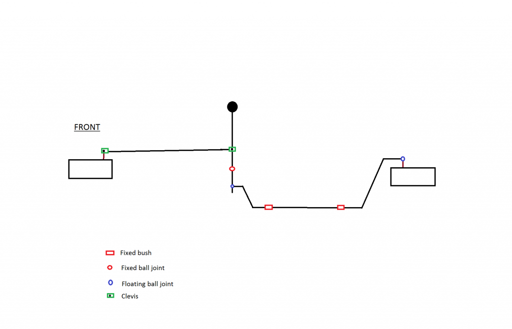

I'm standing by what I said yesterday. When using a single rod linkage the 2 movements it transmits are not forwards/backwards and left/right, but forwards/backwards and rotation. If you move the gear knob to the left, the rotation is anticlockwise, and if that rotation is transmitted directly to the gearboxes then it's 1st/rev at the front and 4th at the rear.
However I've been imagining the linkage attached at both ends with a single 'clevis' type joint, where exactly the same degrees of rotation are transmitted between the levers and rods. Much like the linkage in my car. http://i686.photobucket.com/albums/vv22 ... C11160.jpg
I have just seen a way to do it with ball joints though. Perhaps this is what other people were thinking of.
Personally I'm not keen on the vertical sections of linkage, Although they allow you to vary the ratio of rotational movement, I think they introduce too much flex, the front section is easy enough to use clevises though, which i think makes for a more positive change.
One little issue is that the fixed bushes of the rear section may want to move up and down slightly, depending on what was used as the ball joints.
