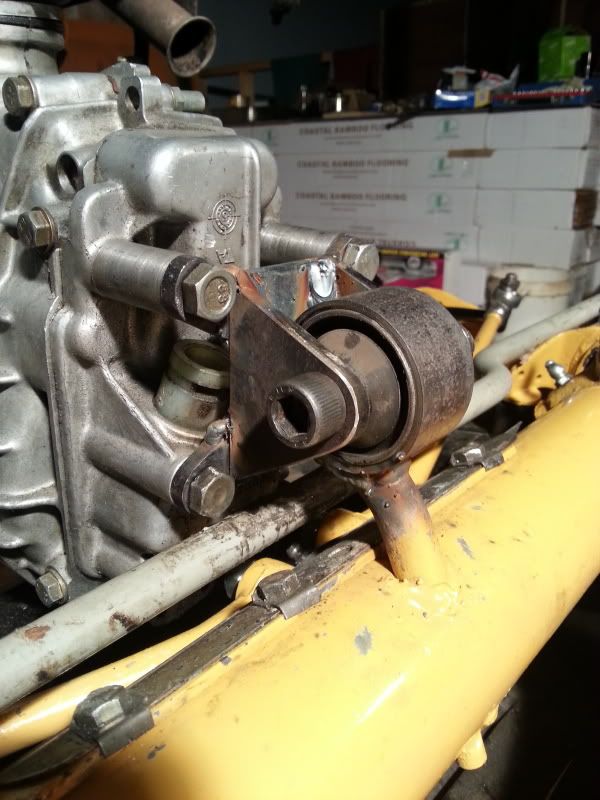

Here is the Lna gearbox mount I made.
just enough clearance for the sway bar...

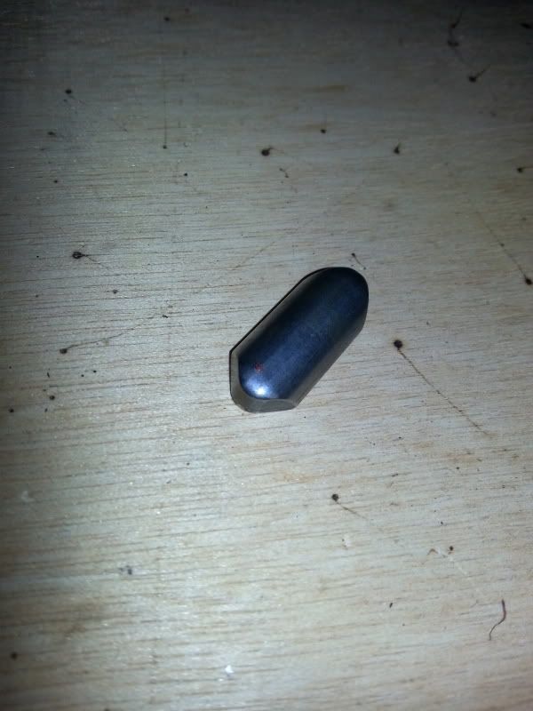

Where have my balls come from!?

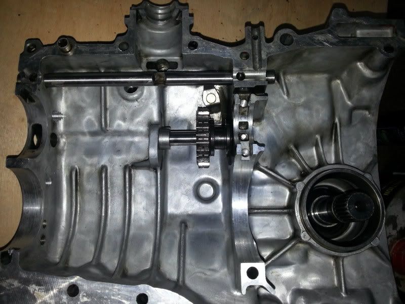

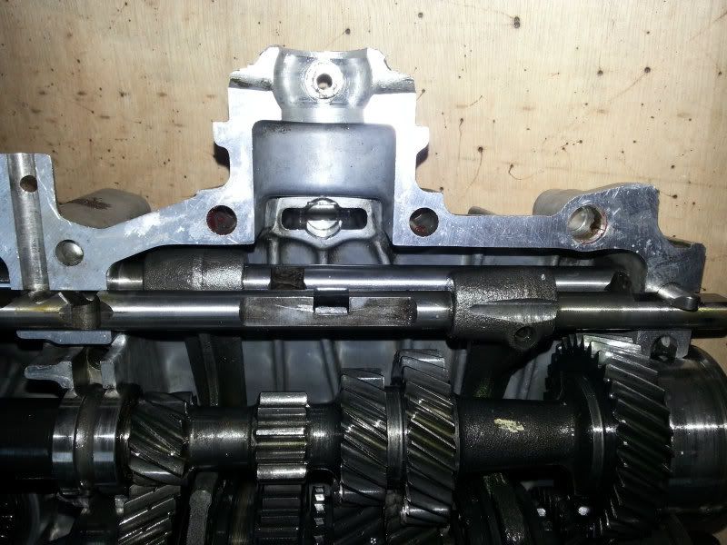

I separated the LNA box to tap some threads out to m10, when I did so a ball bearing dropped out and I am not sure where it is from...
I know it must be from the selector fork but not sure where.
One goes in the channel on the top left of this pic with a spring and pin.
But I found another Ball on the Magnet amongst the oil sludge, not sure if it was already there as this box as definitely been reassembled in the past...

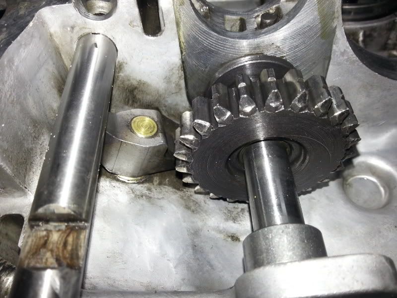

Here is the only wear I can seen.
Cheers,
Harley
July 15th, 2012, 9:18 am
Online
Posts: 2258
Post Re: LNA - GS Gearbox's - Ventilated Discs - Oltcit/Axel
Harley,
Haynes to the rescue, Page 62
You do not have the required permissions to view the files attached to this post.
July 15th, 2012, 9:38 am
Posts: 816
Uuum, I got it back together... then found this on the floor...
Time take it apart again... don't ya luv that.
Harley
July 17th, 2012, 3:51 pm
Online
Posts: 2258
Your are not alone, after the sixth time, you know where the bits go :)

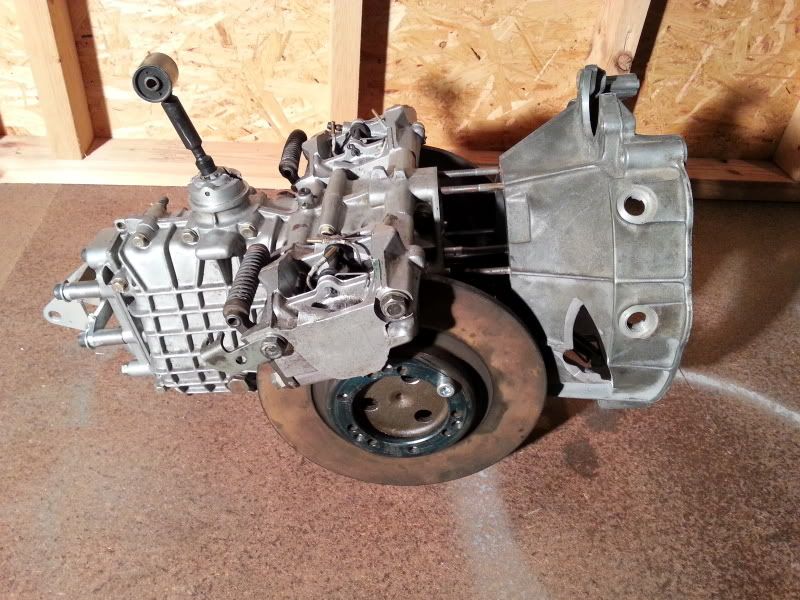

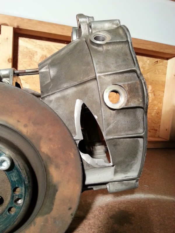

Bell housing cut to fit the disc rotors:
I luv what can be done with a grinder :twisted:
Harley
