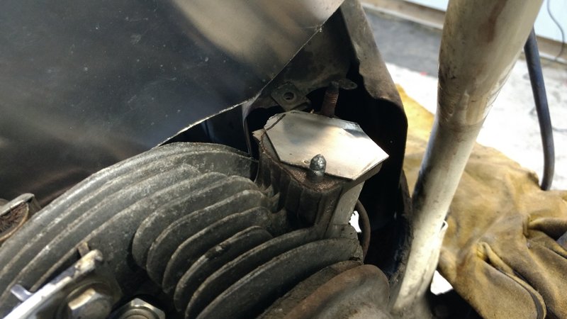

Buggered studs, yeah. No threads left, and broke them off trying to get them out. I've never fail with the welding trick before, but never tried it in aluminium casings before. I was pretty confident on that trick. However, I have another trick up my sleve. I'm going at it now, wish me luck.

With the welding trick, its as much the heat breaking out the corrosion as it is being able to get hold of it. Tried mole grips?

Try welding a nut on!

I have redrilled/tapped to take M8 studs and then use brass nuts, they don't corrode as much.

Getting a grip on the stud is not the problem. The problem is, that it brakes off every time. I've spent 5 hours of my life today on this intake gasket job. And 3 hours yesterday. I mean, I can change a clutch on a Citroen CX in that time, but I cant change a intake gasket on a 2CV in that time.
I've welded the stud maybe 30 times, and braking it off with force. The weld is good, it's just the stud is SOLID in there.
I tried this trick, using a starter battery and jumper cables. Melted the cables at the end. Stud got red hot but DID NOT MOVE. :

When I can stomach to see the car again, I'll pull off the heads and bring them to a machine workshop. I'll ask them to put new studs in, don't care how they do it. If they wanna cut the whole section off and rebuild it by welding, I couldnt care less, I just hope they can get it sorted. Unfortunately closed until 4th of august. I have tried drilling out those studs before on a different engine. Did not go well. I'm not trying that again.
