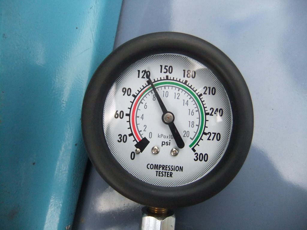

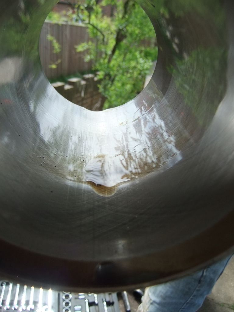

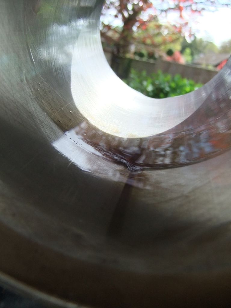

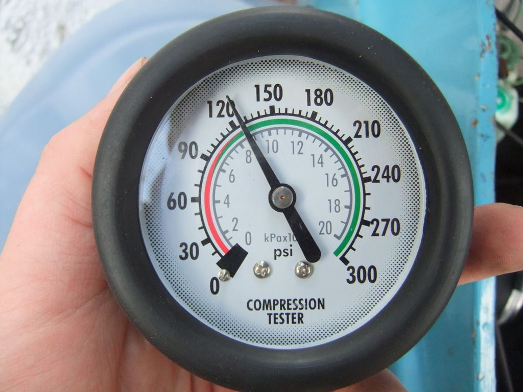

I've decided to use a little bit of intelligence before I strip the car down again so I've taken advice and bought a compression tester. When I took the top end of the O/S apart, I looked down the cylinder and apart from a oily looking piston, the barrel looked as new, with no scoring and its honing marks.
O/S
N/S
I think the ideal for a 9.0:1 is about 175 psi this is obviously under that and just above the red so pretty appalling...

you cant usually see worn barrels - i give any barrel a quick spin with a hone, it soon higlights the worn parts which remain shiny and the good bits are a mat grey
warm engine wide open throttle? if so thats a pretty terminal reading

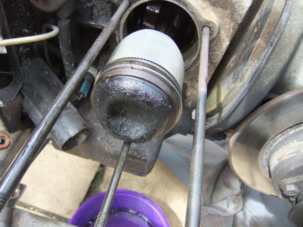

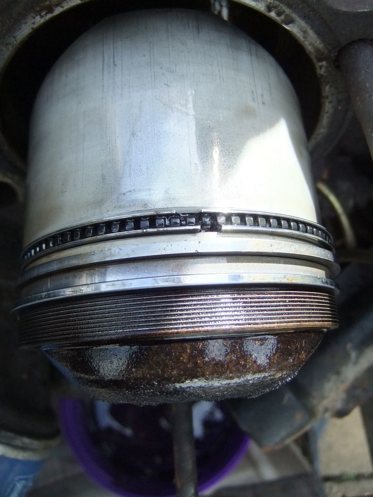

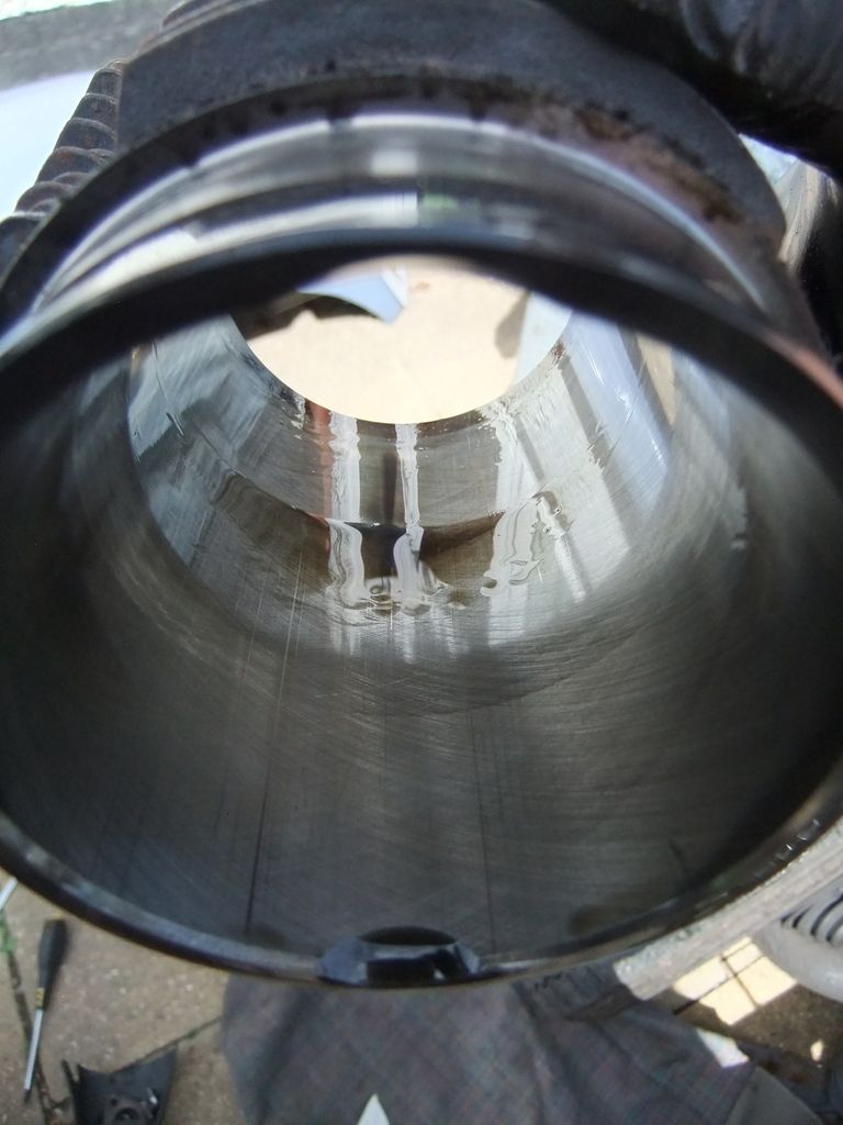

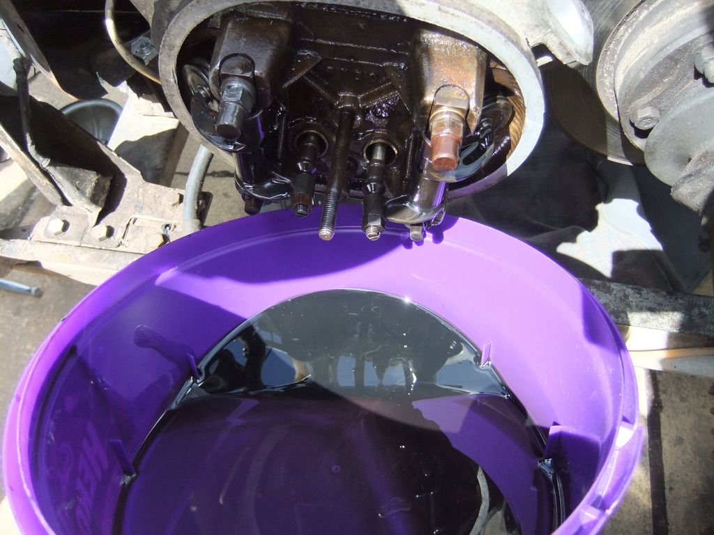

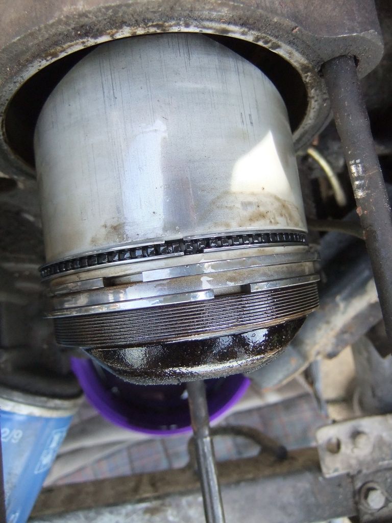

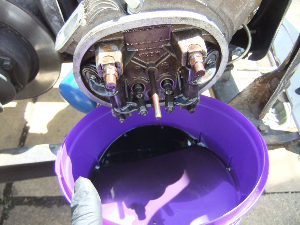

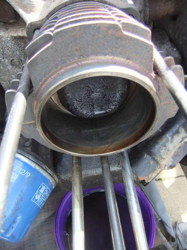

I've taken the engine to bits as far back as I did originally and taken pictures... I don't know whether this makes things any clearer.
The O/S rocker
N/S which looked like it had a tiny bit more oil in it.
O/S

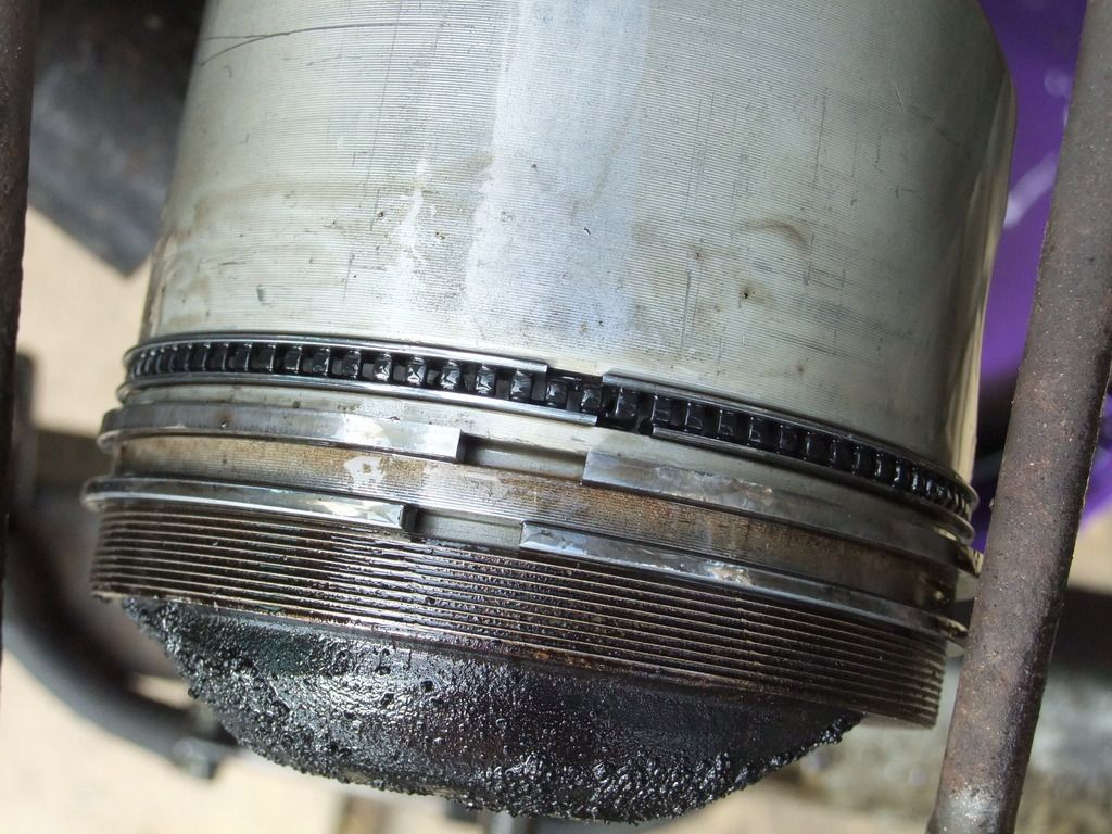

The rings haven't rotated round...
I then rotated the rings round.
Ditto with N/S...
So that's where I've left it. I don't really know what to do next! confused:
I can only assume that the problem is only with the rings or the heads. The barrels, pistons and rings were part of this set. http://www.ecas2cvparts.co.uk/barrel-piston-barrels-pistons-rings-gudgeon-pins-circlips-good-quality-p-511.html
