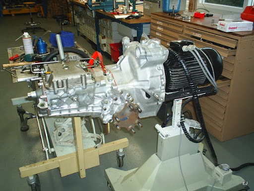

Got my DS 21 gearbox overhauled here, maybe 6-7 years ago: http://www.ds-vitesse.com/en.html
Great work, it looked like a new unit, and was a dream to drive. But many expensive components was changed, like crown and pinion, some gear wheels++. So not just the bearings. I'm sure I might have gotten it done cheaper elsewhere, but I don't regret it.
Here's a picture of my box being tested at the final stages of the overhaul :)
