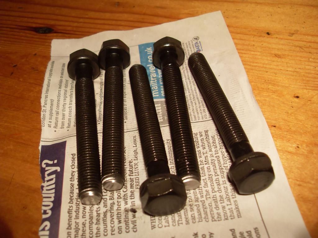

M11 x 1.5 bolts for the flywheel you say, what you mean like these? ;)

Joolz you show off! Hopefully I have similar waiting for me at home. Half term family break so won't know until weekend ha ha. Big fingers crossed that someone at work has kindly modded my flywheel while I have been away! I can then look at fitting it together in the bench.
