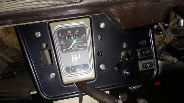

OK, doing a bit of a dash swap today, simple and now MPH......
I find I have a few spaces, I've seen blanks for the wee round holes, are blanks available for the rectangular holes ??
Also, I need a working wiper switch...anyone have these bits for sale?
Swap was very awkward and fiddly.......
Mostly working and I now have an oil warning light......and, no front lights.....Will get it finished over next week !

Ask Roger V if he can print these blanks . He owns a 3D printer as I understand

The little lights you can take out of the other dash they are the same.
Dash is normally fixed with this type of lense shape screws.

I moved my hazard switch to the left side. The two holes at the top I use for left and right indicators. The wiper switch stayed in the bottom right corner. However, in the square hole above it, i have repurposed the brake fluid test bulb button to operate the electric windscreen washer pump.

OK, confused.......
As above, I've swapped the dash. Car starts and runs, I have tail lights, indicator and horn.....I have no front lights, nothing, no sidelights, no dipped headlights and no full beam.
I did have the lightswitch disconnected but I have checked and its all back as before.
My meter says I have 12+ volts coming to switch and when I turn the knob, 12+ volts at all other terminals (except horn)
Any thoughts on what I've missed before I tear it all out again.....?
(I had lights before the swap)
