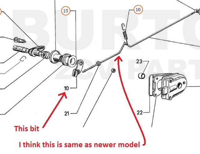

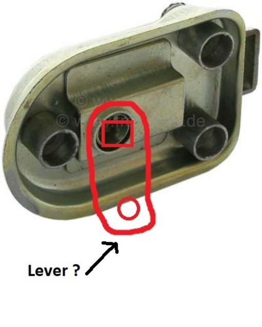

Looking at my drivers door I'm missing the doorlock rod and, the connector at the lock end...so I still have to open window to get to the outside handle.....
I'll have to strip the lock from the other side so I can make the bit of the lever thats missing, and see if I can modify a later lock rod.......(unless someone has these bits lying around??
Its this style of lock and I "think" I'm missing the bit carefully drawn in red..... Can anyone confirm ? I can't find any diagrams...

In fact, found a diagram on burton site but they don't seem to have the bits...
I think the rod is same as a later car but its number 10 I need (or need to make....)

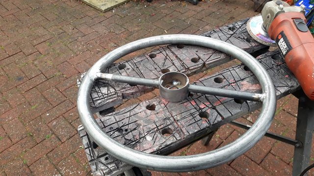

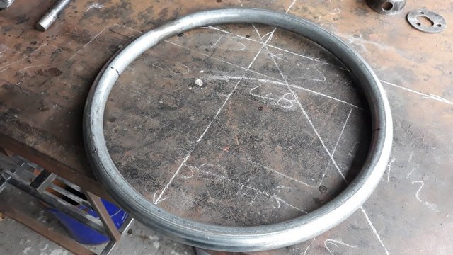

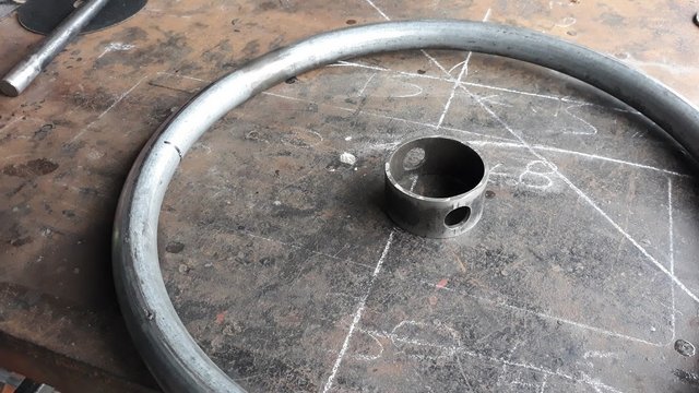

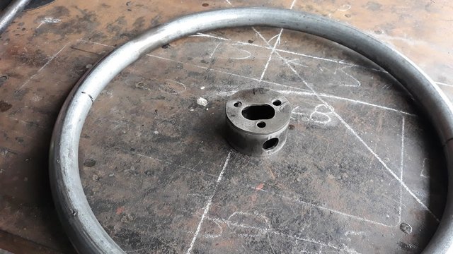

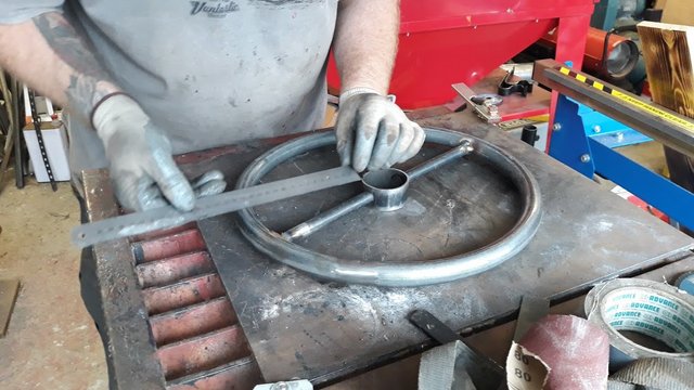

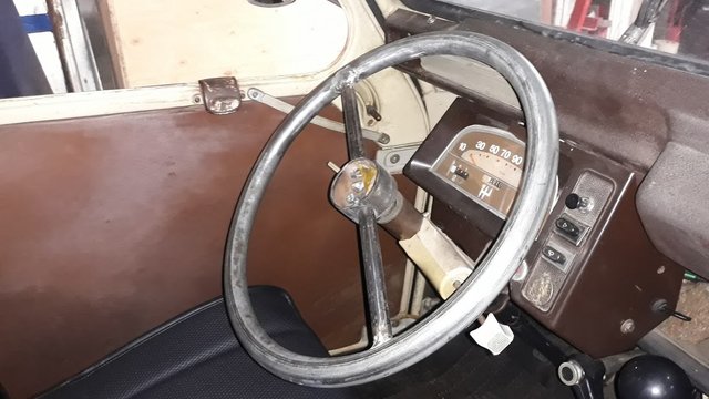

Cockpit has always been a bit tight in the van due to my ample beer belly......
So, a day off today. With 90% of skills and equipment supplied by my mate Jack, we did this today :)
Roll up one of these
Add some of this
And one of these
Measure carefully
Add a bit of skilled welding
And you have this !
Gives me a bit more room to breathe :)
Next is to get a nice wee cap turned up for the wheel and swap out the dash for a flat plate and MPH dial..... !
