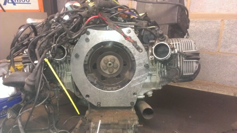

Post Re: BMW 2cv engine conversion
been along time since i last posted but i am making progress slowly. motor plate made, crank/flywheel spacer in the making.
Mine has started getting mega over run recently.. a bit of playing about suggests the throttle bodies may need balancing.
@db78 you'll need to angle your throttle bodies outwards to clear the discs and callipers!
The wiring will be looked at before fitting, plan to run it on the bench first.
Throttle body angled spacers are on my fabricating list.
Have also just got a GSA 5sp gearbox. Need to source a bellhousing next, I believe an LNA one?
That's right, visa or Lna are shorter, you just need to machine slots for the disk brakes.
