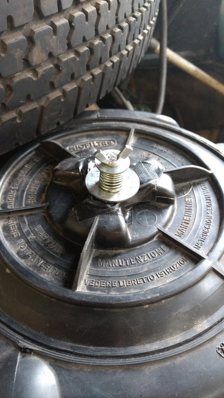

If I never get rid of that backfire, I have found a way to live with it :lol: :P
The spring is not as compressed as it looks, it's about 4 mm movement. Hopefully it's enough to save the airfilter from breaking up more than it has.
Vennlig hilsen, Eirik
