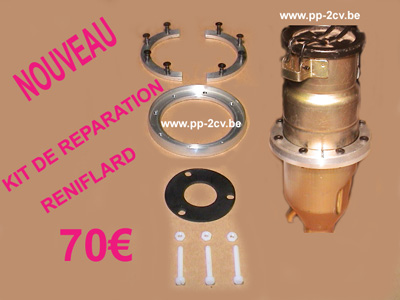

This looks like a good idea, so you can clean or replace the rubber part instead of buying new every few years.

have a few more pictures.
maybe babelfish can help here Neil?
http://www.pp-2cv.be/FR/News/info%20tec ... ard%20.htm
