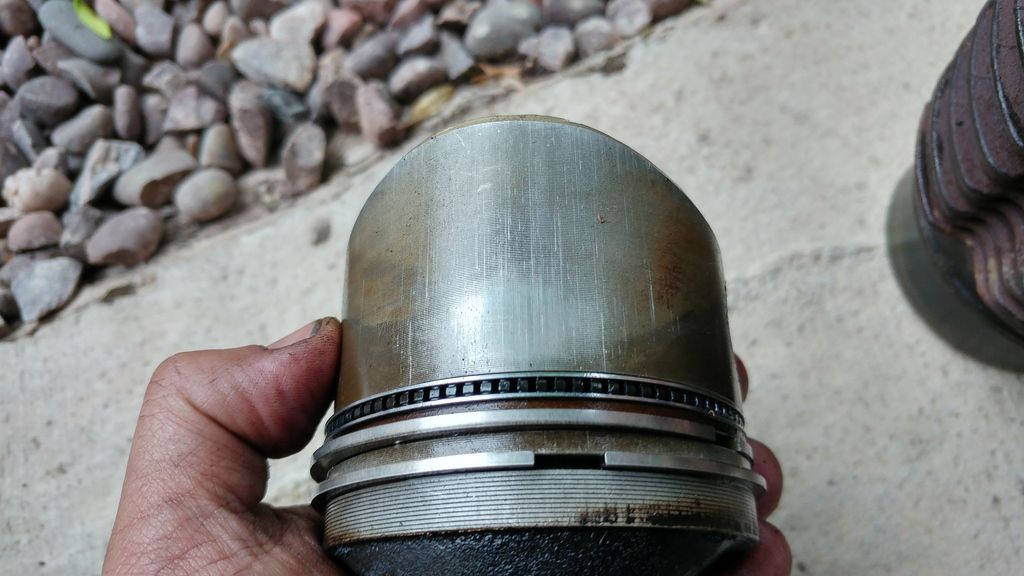

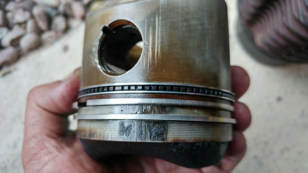

It does sound like it doesn't it? But no it's not tappet or rocker related. It'll be piston/Little end/slap/partial seizure related.
Bonnet slid off last night and I'm all geared up for the engine out and strip down.

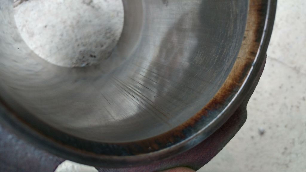

It looks like we've got to the bottom of it..
Partial seizure. New Barrels and Pistons are on their way.
What causes this?
August 3rd, 2016, 1:11 pm
Posts: 1197
Post Re: What to do about my engine.. new one?
Lack of lubrication ?
check if there is oil comming through the oiltube on the barrel .
August 3rd, 2016, 2:06 pm
