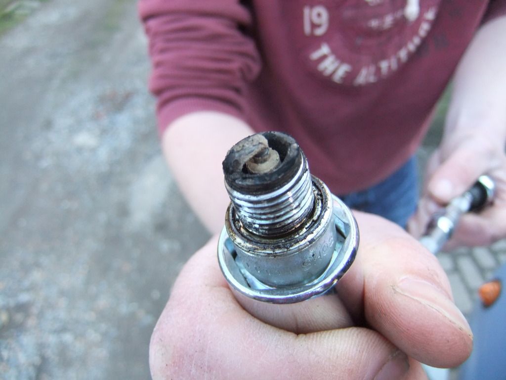

Took the spark plugs out. Here's the N/S which was dry but quite dirty looking...

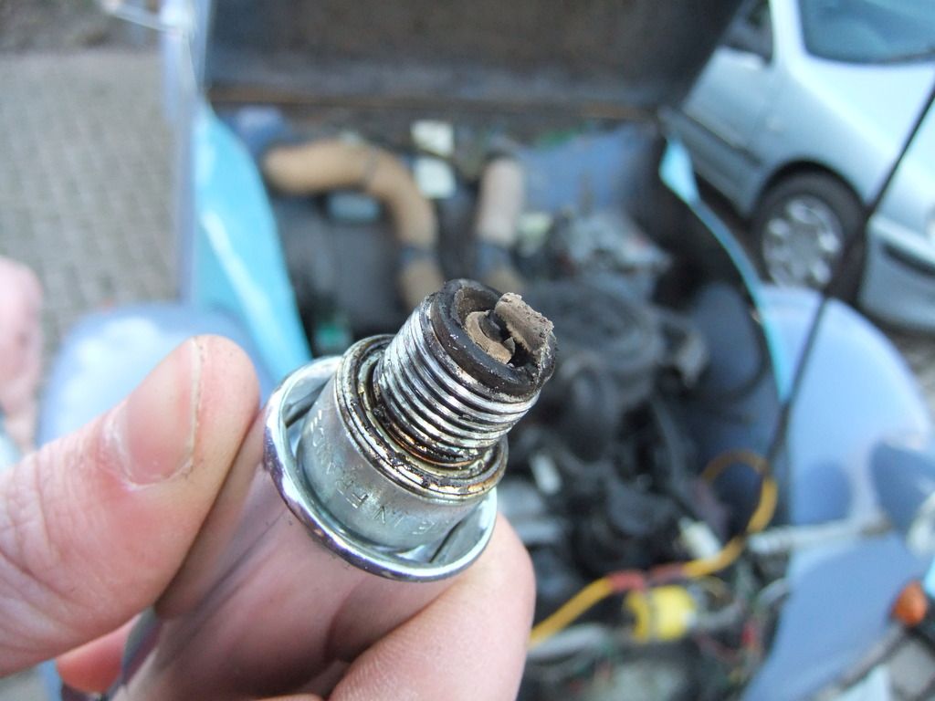

And the O/S which looked cleaner but appeared to be wetter...
Sean wrote:
not nesessarily - have a look at the plugs is one wet or got more deposits?
April 5th, 2015, 8:54 pm
Post Re: Excessive oil consumption
off side is your problem
was the last run of the engine a short one? - the plugs never got up to temp. First is a normal looking plug just a bit sooty looks like it may have been loose, bit of deposits on the centre electrode
Have you had a look at the Valve stem seals the white ones are prone to splitting if the fitting was a bit rough if the inlet split on the OS that could account for the oil being burnt. Exhaust side would make a smokescreen.
Stem seals are going to be head off time to replace (Unless you have a fancy valve spring compressor)
so heads off for the stem seals and a quick double check of the bores and rings while your in there?
