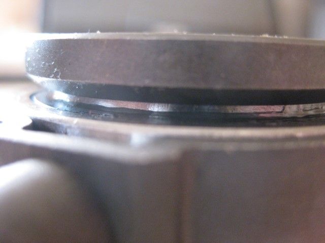

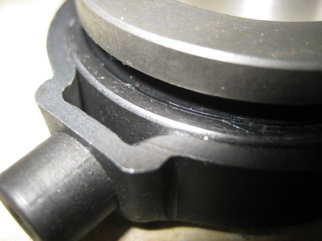

Looks like franzose delivers a bearing in the kit that looks like a graphite ring. Could you tell if there is a bearing inside? And yes pic 3 is the right way to mount the clutch spring plate. It must compress because that is the way your clutchplate is gripped. If you push the pedal the inner disk is raised and gives the clutchplate free.

I'm fairly sure this must be the ball bearing type. It looks like a normal bearing (but I'm not sure how different a graphite one has to look) and the part number and appearance match the ball type listed on Der Franzose. Both types are side by side on this page: http://www.franzose.com/shop/citroen/citroen-2cv/2cvold/outside-of-the-engine/clutch/.
Some close ups of the new bearing if it helps:
Ken: So far it's definitely the friction plate contacting the wear surface of the flywheel which is limiting my fitting of the clutch rather the the OD. Although the OD did look like it might be a close thing once I get it nearer to the flywheel.
Thanks again guys, so many knowledgeable people here! :D

That is a ball bearing one. The graphit ('coal') type has no moving parts.

Ah, I see. Cheers Mike.
