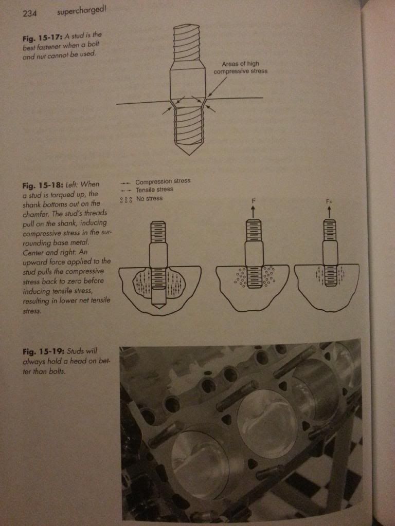

    Reading this thread had this pic come to mind.
    It makes sense to me that a stud will 'distribute the load' better than a bolt.
    Taken from the book Supercharged! by Corky Bell.
