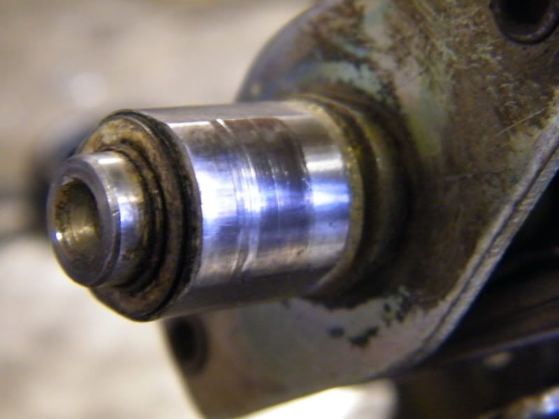

As per Seans prediction. Oil pump has scoring in it, the valves are ok although covered in gunge, the pistons are ruined, the exhaust tracts are full of some sort of mushy rust-like crumbs, the cam lobes appear to have worn through the hardening on the tops with evidence of pitting too. The combustion chamber is eroded too.
the crank makes a clack noise when I 'choke the chicken' and has around 1mm-1.5mm of play at the little ends which you can see if you click the photo of it (it should show a video)
It's all bollocks.
