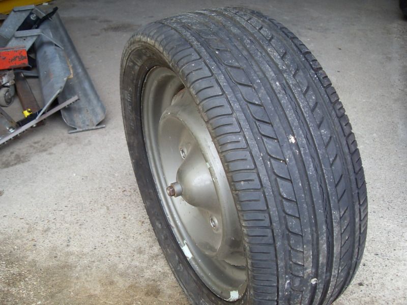

Because I haven't got much to do, mainly for amusement, and certainly not because it's a good idea, I'm providing you with a picture of a 195/50 15 fitted to a 4 1/2" Peugeot wheel. It was a bastard to get on there and I'm sure would be absolutely useless were you to try it on a car.

April 30th, 2012, 10:34 pm

Joolz,
bet it's going to be even more a b#gger to get that tyre off the rim... :lol:
Ken
( Won't GS size tyres, 145 width, be close enough for Louis' car? )
