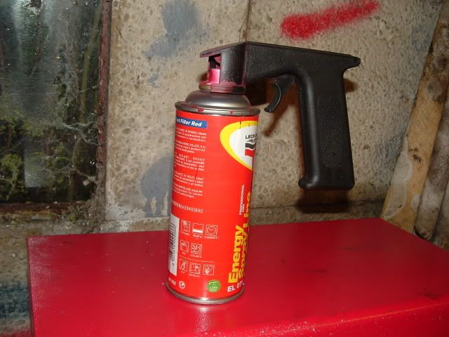

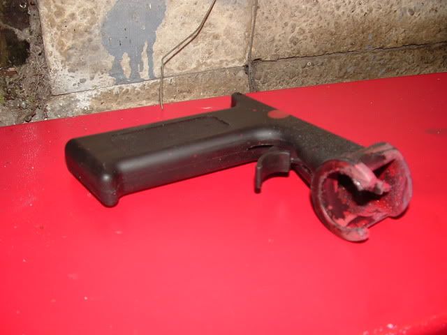

If youre using rattlecans one of these is handy .....
It clips onto a large aerosol like this .....
It's the next best thing to using a genuine air powered spraygun [and it works in exactly the same way]
