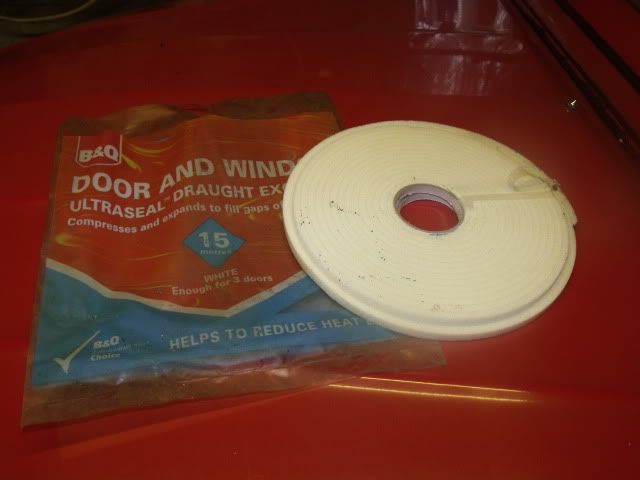

It comes ready rolled,cut & glued from B&Q .... 8-)
....the pack reads "Enough for three doors" ....thats about enough for 30 2CV's [by my rough reckoning] ....take the roll along to your local club night and you'll be most popular bloke in the pub,you can do all your pals 2CV's too .... :|

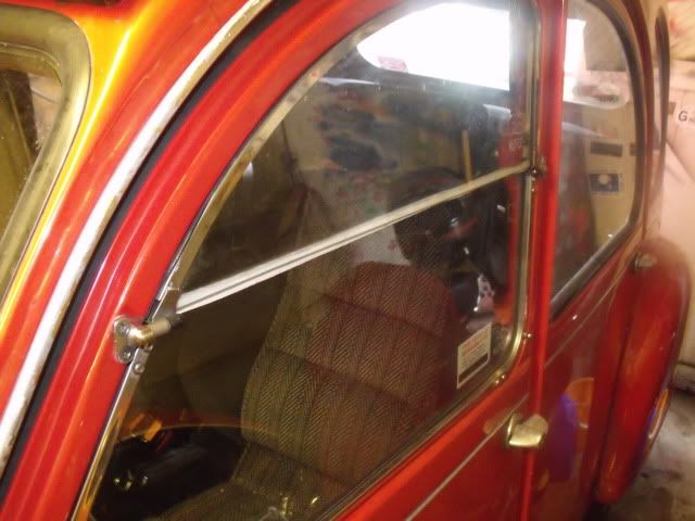

Fitted ..... :roll:
....scrape all the old adhesive off [with a sharp knife] and then clean the glass well first [with meths/celly thinners/acetone or summat similar] ....there's no way it'll stick to dirty glass.
And cutting an old piece of carpet to size is hardly rocket science .....use the rubber mat as a template/pattern .... And dont put the carpet under your rubber mat,cos all it'll do is hold water when it gets wet ......and ultimately rot the floor.
