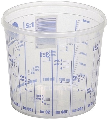

You should mix the paint and harderer before spraying, but only as much as you need at that moment.
So it is difficult first time to know what amount you need.
I used this : http://www.topworld.nl/media/catalog/pr ... tc5mtk.jpg.
It is a measuring cup to mesure paint and hardener .And it is cheap ! But you have the exact amount of harderer to the exact amount of paint.
Mix the paint before you pour it into the measuring cup and mix the paint and hardener again as it is in the measuring cup
