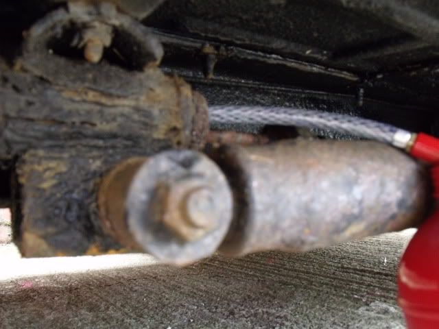

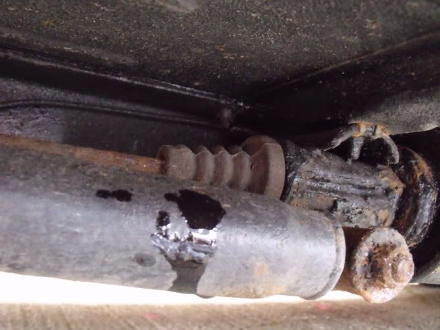

I'd guess your suspension can needs oiling ....
A picture speaks a 1000 words ....so here's the cure.
Remove the rubber gaiter ....
....insert the end of the oilcan spout and give it about 6 or 7 good pumps.
It helps if you can rotate the suspension can in between "pumps".
Dont use engine oil,gear oil,WD40 or LHM .....you need veggie oil, or castor oil .....[you could of course use "virgin olive oil" if you wanna do it the expensive way .... ;) ]

same problem,
turned the can around so hole in it faced upwards,
as if like magic no squeak, im going to put some oil in anyway,

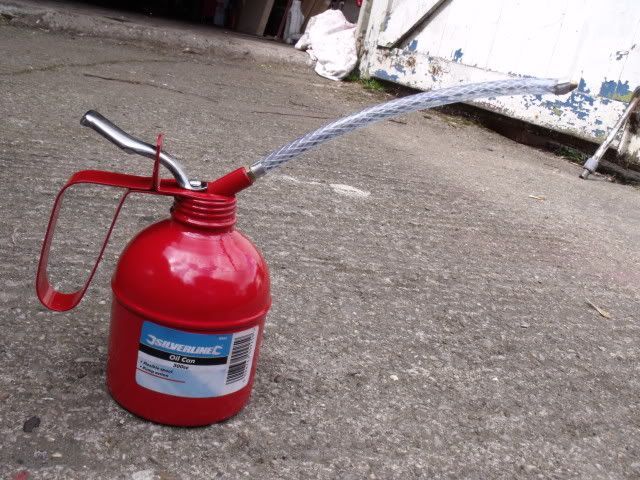

what sort of oil pump is that?
and ive talked about this before, and had replies, but in your opinion is used cooking oil ok? its alot more viscous and alot less runny

"what sort of oil pump is that?"
Oil 'pump'? Oh the one with 'Silverline Oil Can' on it's label..... :geek:
