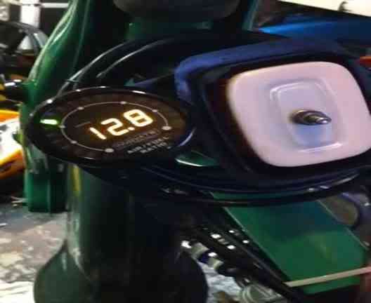

Anyhoo I've Drilled an old Mikuni jet out to 98 size and that has stopped it pinking. I suppose I should really weld a Lambda bung in the exhaust and cast my AFR gauge over the setup. It does look rich at idle as the plug ceramics are bone white but the base ring is sooty black.

I did pull the plugs today just to check and the porcelain is still bone white.
It was only pinking on the second venturi hence the reason I homed in on the secondary jet.
I think I will weld in a lambda bung and see what's going on, it made tuning the bikes soo much easier.
