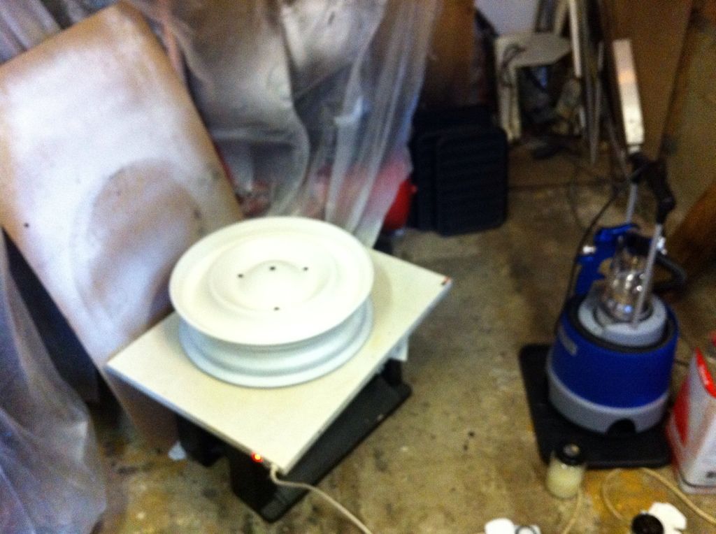

Enter the Earlex hoover powered spay kit (apologies for the picture quality it's off my phone)
Etch primer and white filler primer later, it's time to apply the silver..........7 coats later it still doesn't look silver to me but I'm bored applying coats now so stuff it and get the job finished.

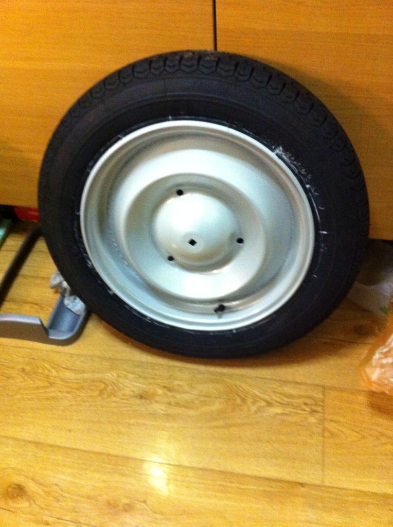

Bingo Bongo, I have a spare wheel again:
Now this may seem mundane to some but this is the first car tyre I have fitted.

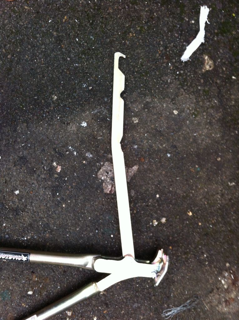

First I had to modify my bead breaker so it will fit over the domed bits on the front of the wheels, apply angle grinder and a bit of bending and the holding arm now looks like this:
At least now it doesn't pop off the rim each time you use it.

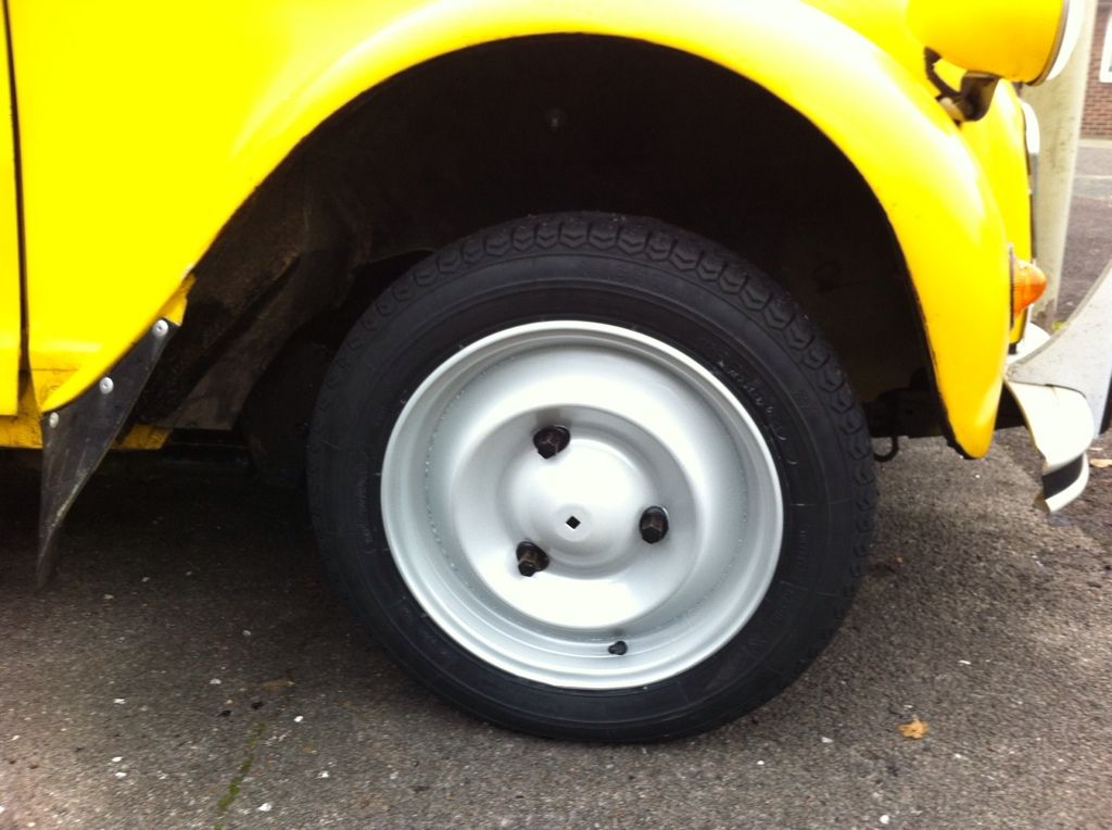

And on with the new Toyo's.
Just to prove the old adage "There's always one", when I popped off the last tyre the rim turns out to be scrap, the tyre takes a fair amount of rim material with it (former steel, now flakey rust).
So the Acadiane has to wear the newly refurbed spare 'till ECAS can deliver a new rim, and I'm without a spare again.
Still, at least the car's wearing new boots at each corner, how the old cracked ones were holding air is some sort of miracle.
