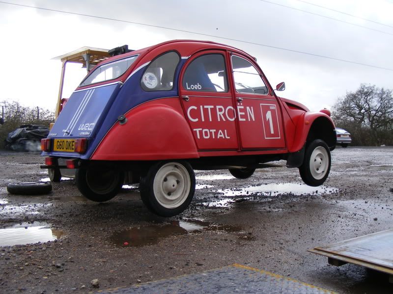

An interesting thing i did discover: My rear near side wheel never comes off the ground, no matter how high you jack the car.
You need one of these.
April 27th, 2009, 7:07 pm
Post Re: Adjusting suspension heights
that would be quite useful... :lol:
