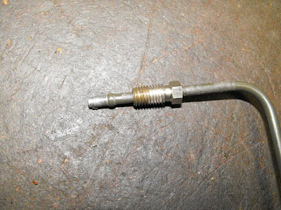

I didn't use any extreme torque.
So between the brake fittings and calipers there are rubber seals? It's not flared like a typical brake line fitting?
When I mean typical, I mean like this:
May 18th, 2017, 6:27 pm
Posts: 341
Location: West Sussex
Post Re: More surprises!
They are like this:
The seal goes on the end of the pipe and is compressed as the union is tightened.
(This system was used on the big Citroëns with very high pressure hydraulic suspension, brakes, etc).

The seals look like this:
http://www.ecas2cvparts.co.uk/brake-pip ... -1300.html
