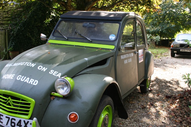

As you may or may not know I have been on the look out for a left hooker for this journey (Cameroon Government will not allow RHD vehicles) and my search has finally ended with the Walmington. Thanks to the wonderful Doug Webb from Mr Barbour's garage I am now the proud owner of the following:
1982 Citroen 2CV6
Frome chassis
Pretty good 'shed' condition
Soon to be LHD
Done out in a Dad's Army homage style - Matt green and lime trim.. stunning
Suspension a little worn but works.
Union Jack boot - been replaced with old bootlid with rather fetching UDAC 1985 sticker
Modifications - sump guard already fabricated and in place. Fuel tank guard soon to be fitted.

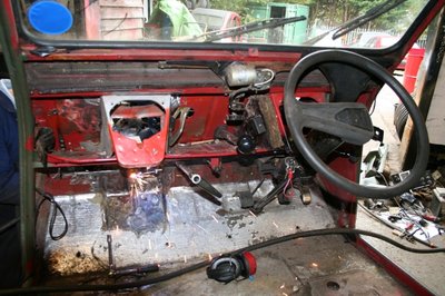

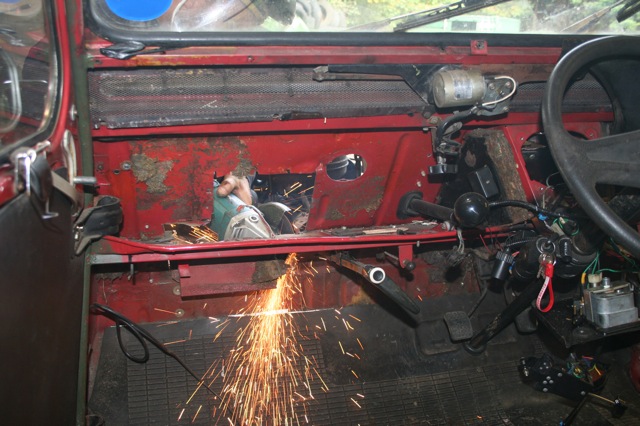

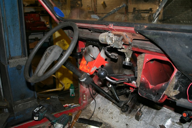

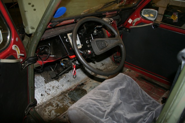

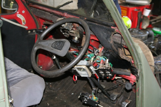

Africa Rally prep update:

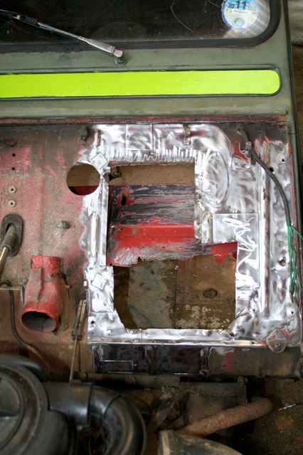

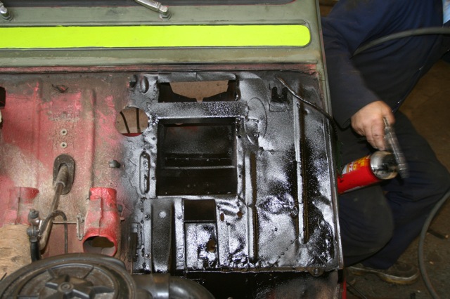

On Saturday at 9am after a strong coffee and a bacon butty, myself and Mr Barbour started the conversion of the Walmington to left hand drive. The Africa Rally stipulates that all vehicles taking part have to be left hand drive so that they can be legally imported into Cameroon.
Thanks to Graham Wilson at the 2CV workshop for cutting me a piece of bulkhead and a huge thank you to Neil who met me on the M4 on his way to Spa to deliver it.. I now had the jigsaw piece required to swap the controls over. Together with a LHD rack we dived in..
Dash and loom comes off
Cutting of bulkhead
Hole ready for scrap bulkhead
Welded up and painted
Hey presto new dash
Wheel and column swapped over
Finished (bar a few bits and pieces)
Apart from a few hiccups I managed to drive the car home for midnight. It still needs a bit of a tidy up but essentially I now have a perfectly usable left hooker. Thank you Louis for another stunning effort... next job engine change.
