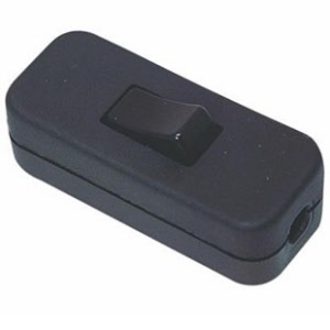

I use a cord switch with one cable to the battery and one on the starter. Then you can do it without anny help.

Use this ...
http://www.ebay.co.uk/itm/1-x-Easy-Engi ... 5667355ea8
Harley would know it as Start You Bastard..
