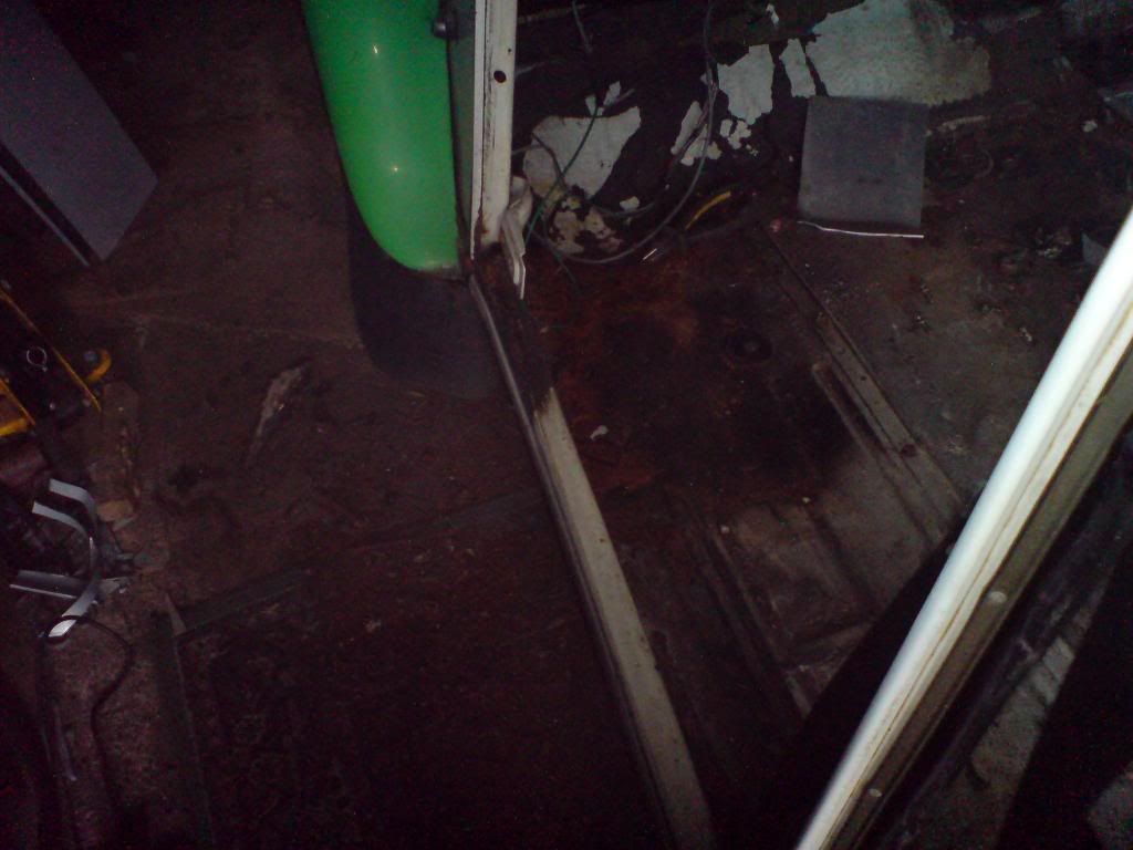

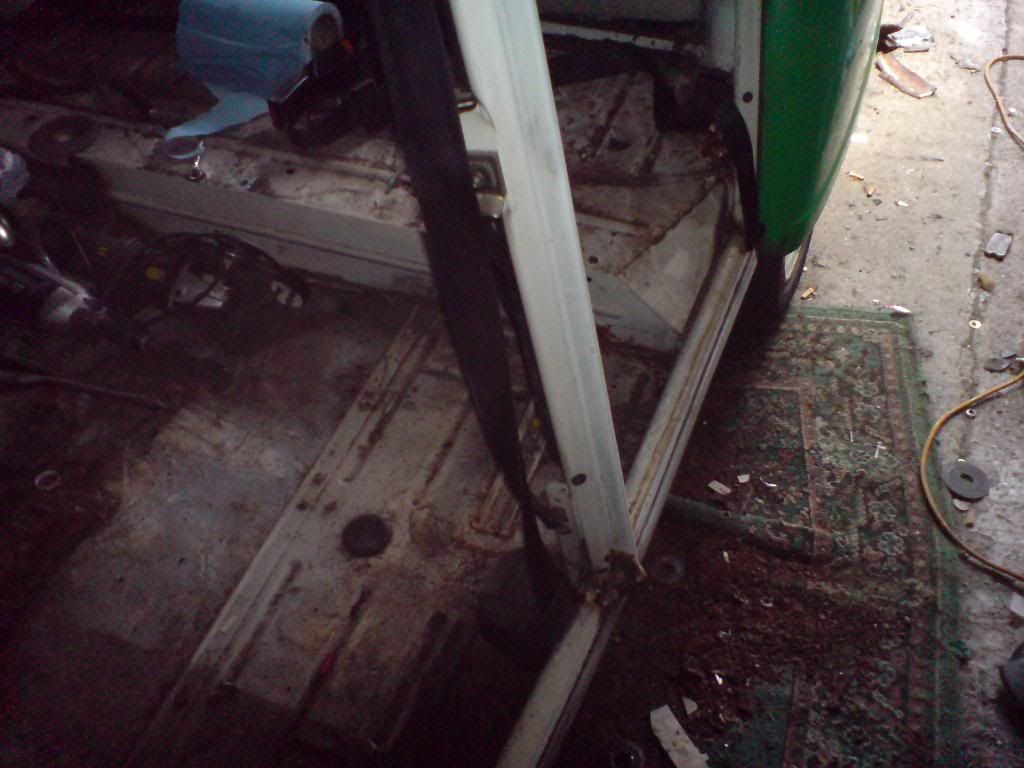

I've been charged with the task of getting it back on the road again. It doesn't take an expert to realise that it's a bit shagged. :lol:
When I sat in it, I heard a creaking sound-wonder what that was? :?
Aaah, I see.........

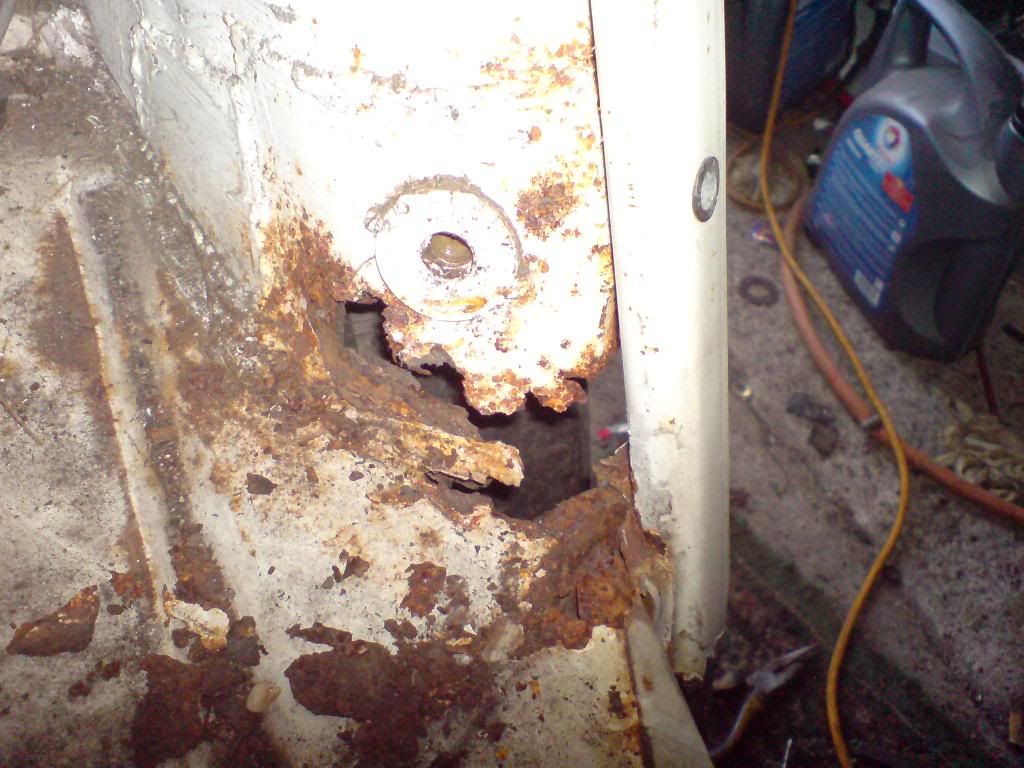

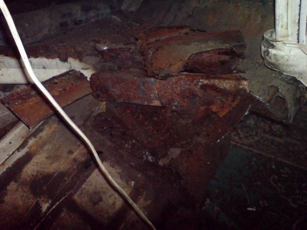

The bodges that have been done to this car are criminal
It's layer upon layer of 1MM plate pigeon shitted into place, in fact, it's not even pigeon shit-canary shit more like!

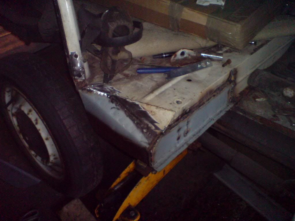

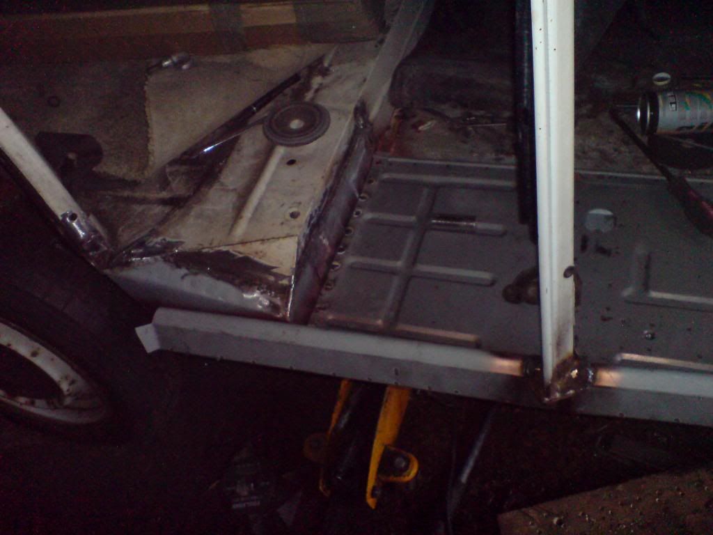

I've cut the drivers floor and sill out, repaired the seat box and tacked in the floor and sill to try and stiffen the shell up a bit. Tomorrow I'll be bracing the shell some more so I can get the shell off the chassis.

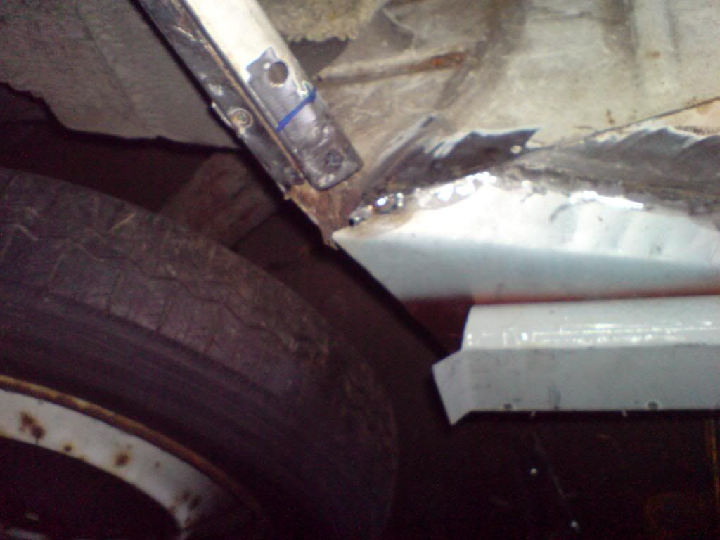

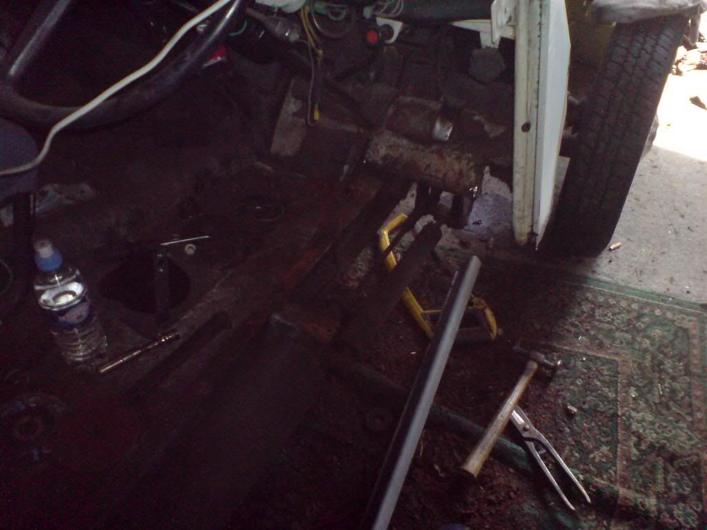

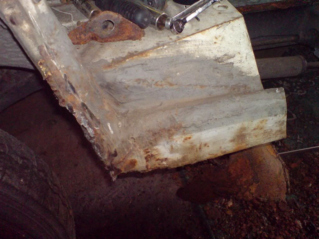

I tidied up a few loose ends on the drivers side this morning
With a home made C pillar repair section
And then moved onto the passenger side

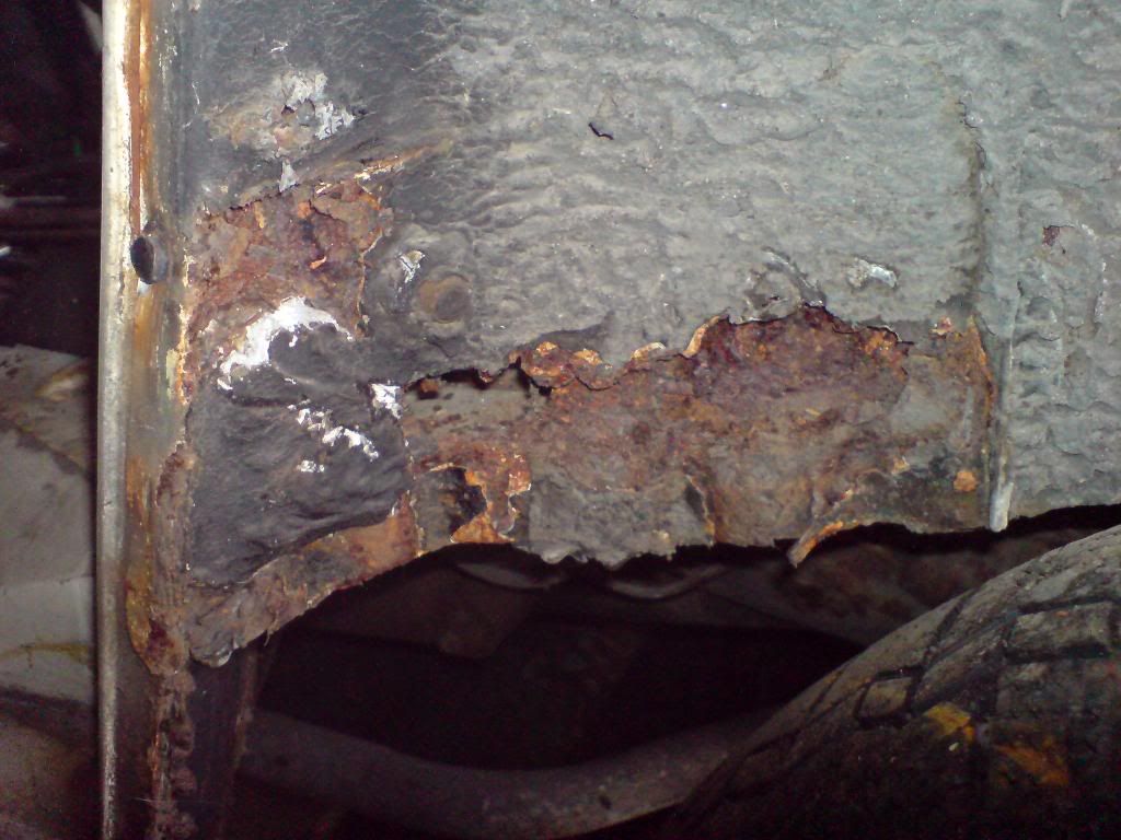

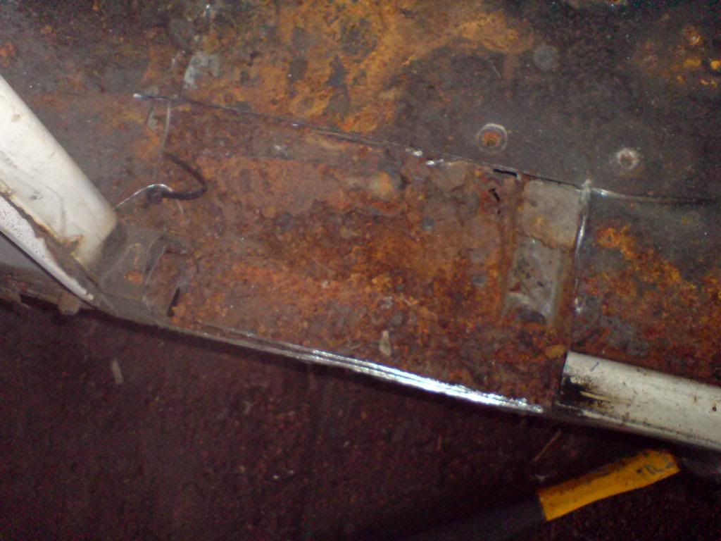

He paid £100 quid the other year to have the N/S/R seatbelt mount repaired, money well spent?
I didn't think so either!

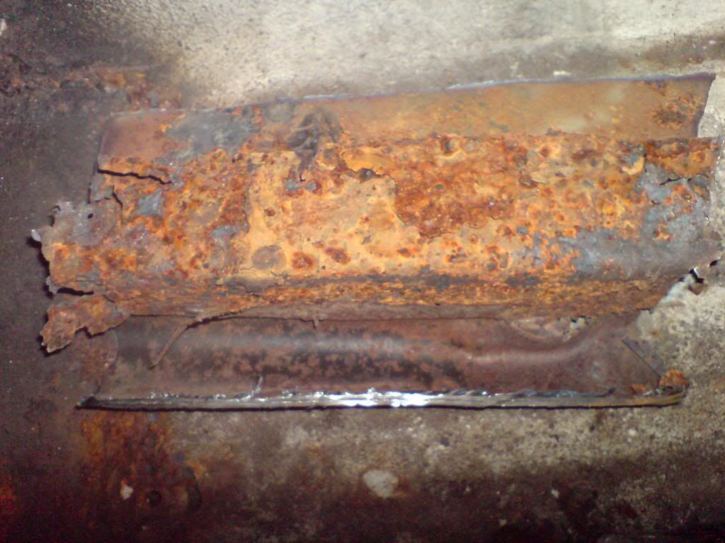

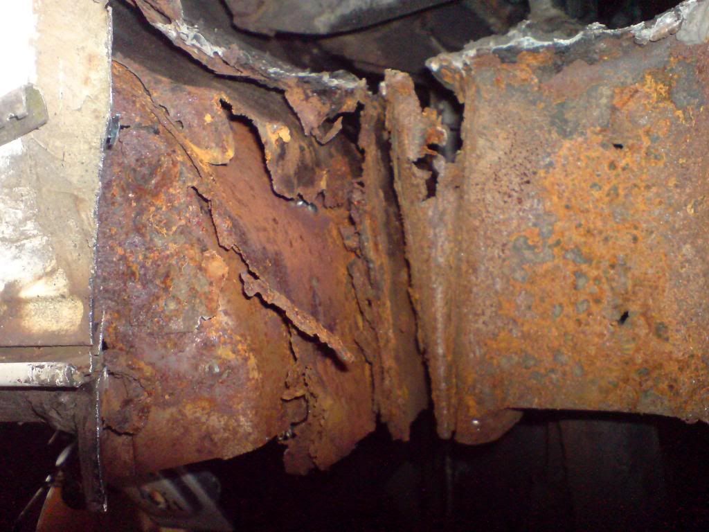

This chunk of rust......................
Came from here

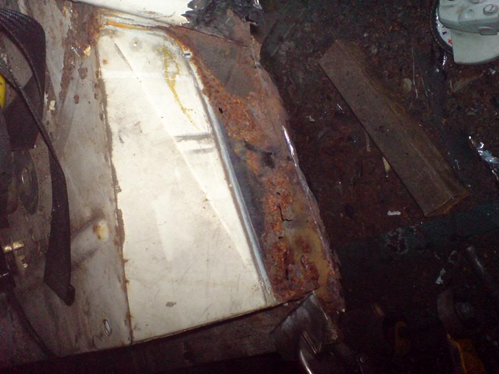

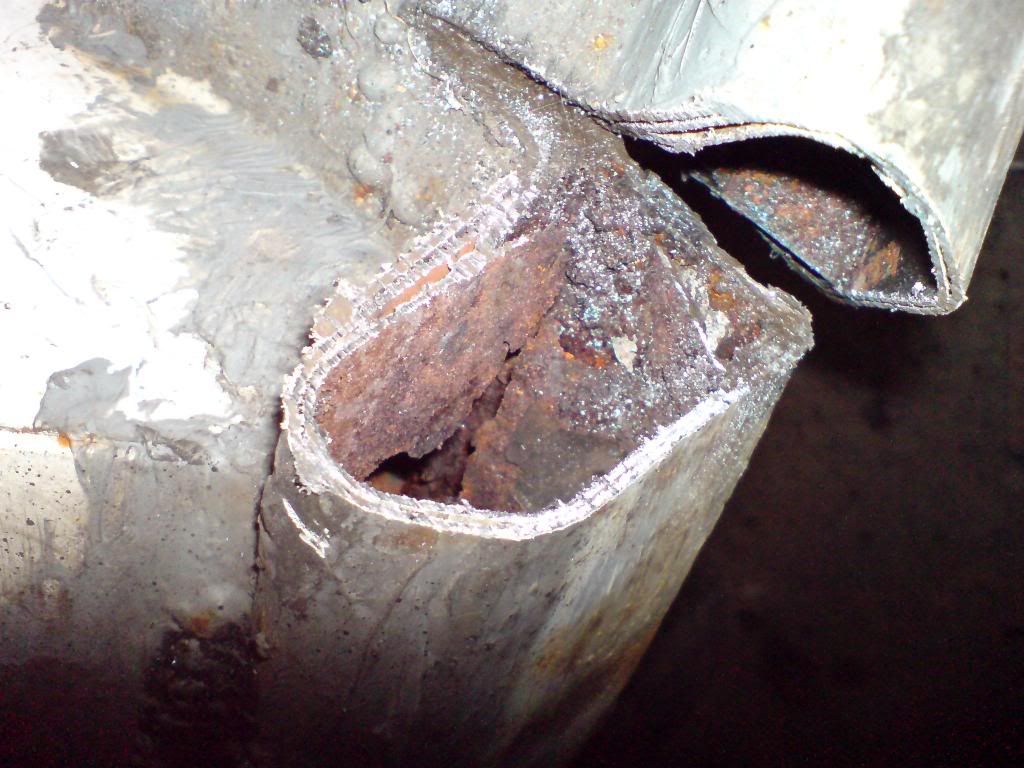

And lastly, don't we all love it when twats weld the floors/patches to the (galv) chassis!!!
