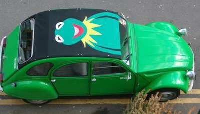

Kermit has been in the family since 1993ish, English import, it was the car I drove to pass my drivers licence and I have had it ever since...
Kermit started it's life as a '74 square headlight drummer...
Now it has a Channelled body, Suicide doors, Custom tailight panel, Removed 3rd window, Greasable font wheel bearings, Reinforced chassis, Chopped reclining GS seats, Uprated springs, Rose joint tie rod ends, LNA gearbox w/ GS disc brakes and calipers, Megasquirt multi point fuel injection
I have modified Visa 652cc which should be complete very soon!
Twin spark, Forged pistons, Larger inlet and exhaust valves, Custom cam, Anti surge oil pan, AMR 300 supercharger, 1-2-spark :D
