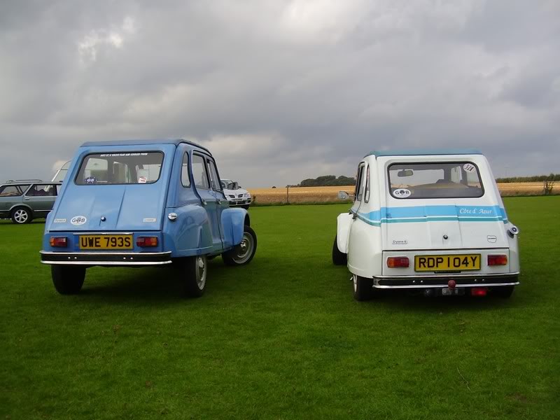

Only picture I could find in 7 or so mintues, sure Neil has better ones, of how low he use to have the beast!!
Does look nice and I bet it only took him a few mins!! :)
