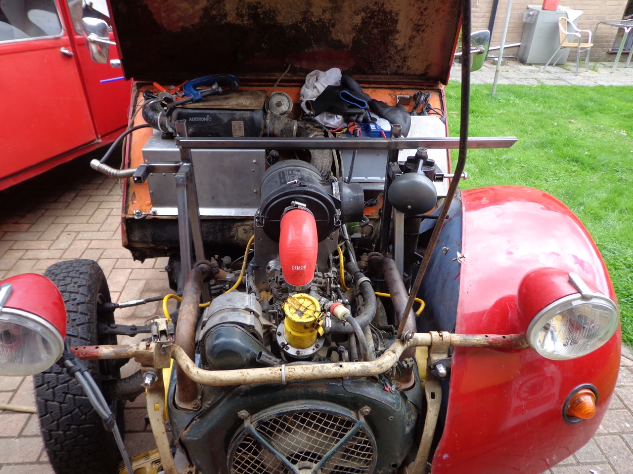

Thought I would try adding C5 struts/spheres to the the road car.
Plan to leave the standard springs in place and run C5 struts/spheres un-pressurised.
Only pressurise the system, when extra ground clearance is needed.
Strut support for both sides, complete.
Need to fit Pump, tank, pipes, wiring...
