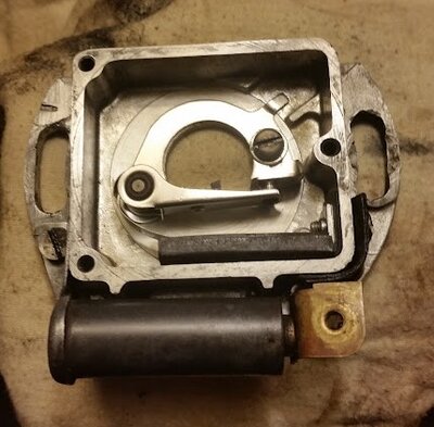

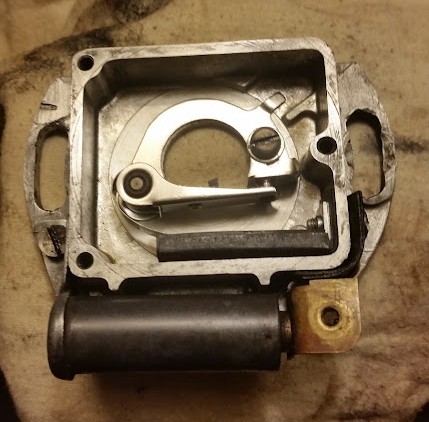

Well that was only once....Yesterday it didn't want to start at all. This morning i did put a sparkplug in the cable to see if there was a spark. When i turned the engine by hand there was a spark. But when i started it with the starter motor the spark was very weak and it missed some. So i took the ignition out and to my surprise both contact points had a coat of oxydation on it... So all out to clean. And with the fan out i did also find my non detectable oil leak i think. Both bolts that hold the oil cooler were wet with oil....So i think there is something wrong there. Let's see if can repair that too.
