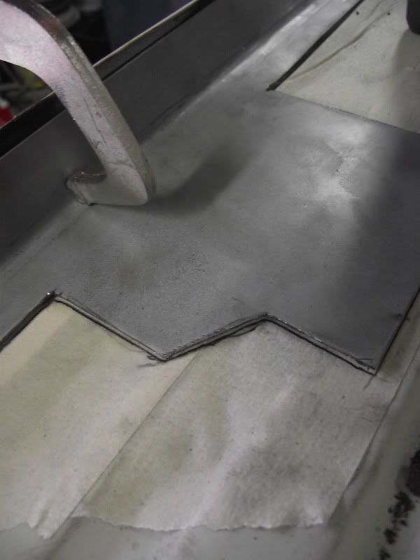

I then made a repair patch, and placed it over the corroded area, drawing round it with a pencil.
I then cut out the area, using a combination of 4.5" grinder with 1mm slit disc, a cut off saw, die grinder with carbide burr, and again, a spot weld drill bit. I cut it out keeping about 5mm inside the line.
That enables you to offer up the repair section and mark it out accurately. I always put masking tape on the area to be cut, makes marking out easier. Place the repair section where you want it and clamp it in the correct position. Draw round it very accurately.

I then offered up the repair section, clamped it in place, and tack welded it all round.
Then I seam welded it, doing 10mm at a time, alternating from end to end, to prvent heat building up and causing warping.
