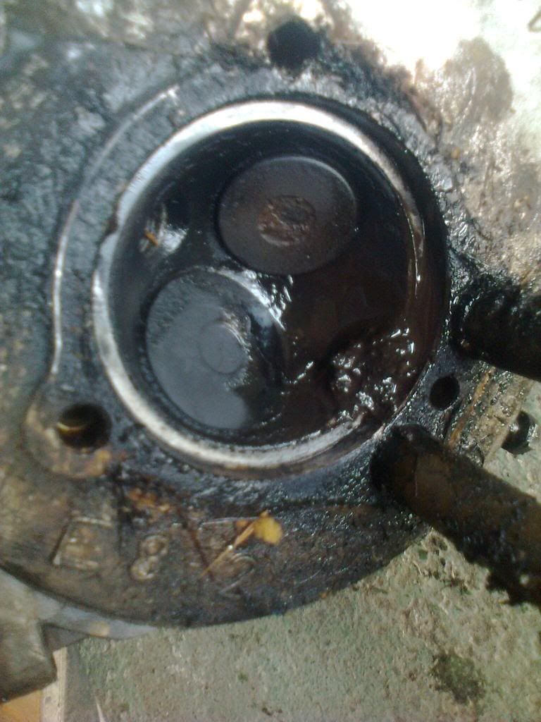

the head came off easily, to remove a load of sludge. it seems that kens marinade had worked as it was all quite liquidy but a lot of it
when that was cleaned away I had a look at the coking, not too bad and scraped away most on the cylinder head. I didnt want to take the valves out because I don´t have a spring compressor or anything. the theory now is to put it all loosely back together to see if it spins easier. I was careful not to move the flywheel when the head was off because that would wreck the timing no?

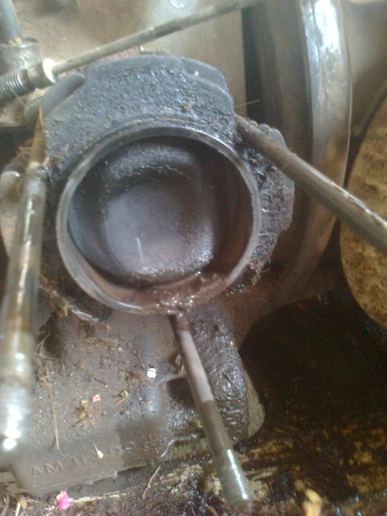

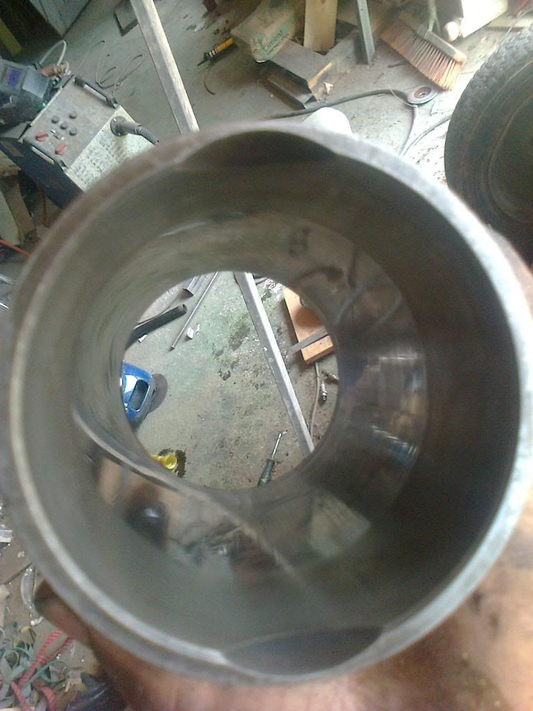

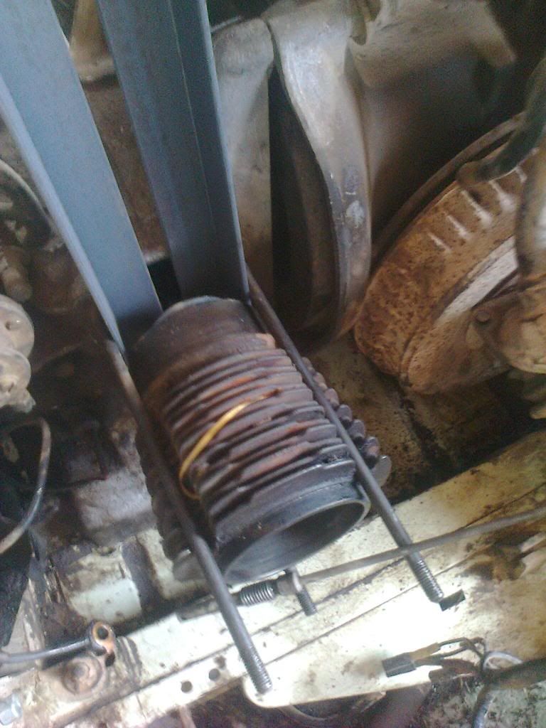

bingo! its the pistons, well actually the left hand one (from drivers view), heads off again , andf the barrels off ( the left hand one was very stiff, had to use steel bars and flywheel to free it.
weirdly the inside of the barrels are smooth and clean, the pistons look a bit burnt on the engine side..is that a bad thing?
now i´m in totally new territory, all the rings looked ok to me, still springy, not really sure what I´m looking for, why would it be so stiff????

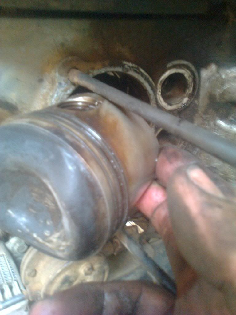

BLAME IT ON MY SAUSAGE SANDWICH!, which made me think about the lubrication in the barrel, so I went back to see where that little oil tube sprays to, the inlet valve no?..so that didnt answer anything, but then on closer look at the rings , number 2 on the stiff side was stuck, it sprang but didnt turn in the groove. so all doused in petrol and loads of black liquid came out the grooves, and they started to move more freely. so with the aid of an electrical screwdriver the barrels were placed on again (pre - oiled) and fitted better...a bit of hope I thought! :?:
so back on with the second, and whoooosh, I can now spin the engine with the hand crank easily, and it makes really nice compression noises, and the valves are moving well.
