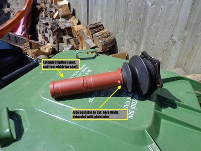

Only one flamin' good weld required if extending the inner though :) , and less chance of imbalance I reckon.
I have two scrap inners from the Ebay Dyane engine and gearbox.

:mrgreen: speedo will stay, even an BMW engine see Geo's car. Braking system will be a bit more work. Suspension don't know if it can handle the heavier engine.
Other poss, alter the carburation as they did in the 50s. Or go to an 425 18HP engine from the 60s. Think about it in the sun... :ugeek:

Fwiw, I've just remembered that Louis Barbour did this on his 4x4 conversions, fitted with later driveshafts, to limit the chances of the inners and outers becoming separated as a result of their extreme ride height and those machines take some hammer....
"Extended droop stops, as a temporary solution to the dangerous setup which was in place when this van was imported from France. "
AZL57 wrote:
I did some measurements. The new one is about 35mm shorter than the old one. The splined portion of the new one is about 2cm longer. Would it be an option to alter the bumpstops, put them a bit higher.

Thank you Fer :) I did read the flickr text and noted that the bumpstop alteration was temporary/emergency/get you home but flamin' fix it properly :) .
extending the inner would sort it, when cornering hard you'd need that extra 35mm. :mrgreen:

My 2 splines worth

Yep, that's extended! Cheers Pete.

Think the other way round.... Put a metal tube 20x20mm or big bolt and some nuts underneath the frontarm stops at the chassis ..
so you shorten the down-travel of the arms, so the driveshafts dont fall apart.. Clever eh..
And it cost next to nothing..
This is standard on a Ami (bumpstops) so why not at your car..
When I jack the front wheels I always put something underneath the front stops so the tyre comes immidiatly of the ground (to change tyres for instance)
