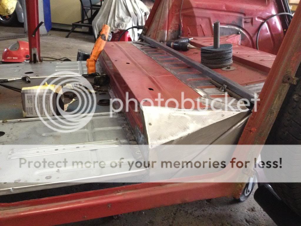

New side panels made to drop down from the rear deck back onto the sill panel, the new floors lined up and bolted up then welded into place. Notching around the B post seemed a slow process i did not want to cut out to much in one go...

I want it to look as factory as possible..

The boot floor will need some work to get right and will have to be welded to the rear panel 8cm higher ... at least the welding marks can be hidden behind the number plate and back lights :)
