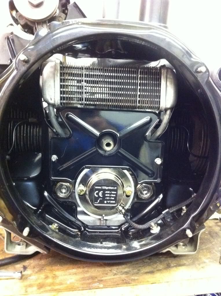

Almost finished assembling the engine.I have decided to fit 123 ignition,purely to get rid of the points and condenser.I dont see the need to use them when an electronic version is available.Now I know this wont please some people,but its my choice,and thats that:D.

Dave,
not sure which type of 123 you've fitted, but if it's the basic version with only one advance curve, bear in mind that the target ignition advance for M4 engines was between 24* and 28*, compared with 28* to 38* for later 602 engines.
If you set the 123 statically on an M4, which has the pin in hole point at 12* instead of the 8* degrees on later engines, it's going to produce more total advance.
In other words, you might find that you need to retard the timing from the M4's static setting.
Ken

Hmm,I was wondering about the advance on this engine,so is the pin hole at 12*?

Yep, 12* is the 'static' point on M4 and the other 'old style' engines.
123 has a shallower advance curve ( unless they've changed it yet again ) than the centrifugal setup, so you'd probably be OK, but I thought it best that you are aware of the difference.

Thanks Ken.I didnt know that,it was on my list of"things to find out" before I start the engine.
